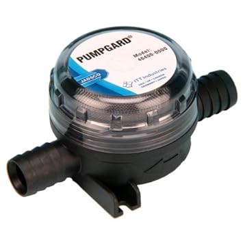

On both ends, where that filter was, I put a piece of hose and fitted this kind of Jabsco in-line filter. Much easier to open and clean.
http://ecx.images-amazon.com/images/I/41Ddy-ZOQmL._SY355_.jpg
I still have a leak on the waterpump input. Unfortunately the Bavarias have no shut off valve by the tank, so every time working on the water system one has to run out all the water before working, Still a lot running in the bilge, where it is hiding in the hollow cross beams and coming out in small portions (while sailing and heeling), so I am never sure if it's fixed until bilge is dry for longer period.
