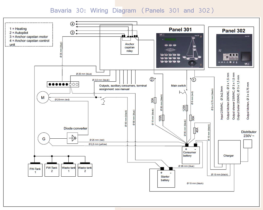

A follow-up - looking at this circuit diagram, it would appear that the shore power supply goes direct to the charger and the batteries before the isolator switches - https://c2.staticflickr.com/6/5463/9525167586_07798f548d_b.jpg - or am I missing something?
Family problems have kept me from the boat for a couple of months - I've left the shore power connected but the two isolator switches and the switches o the panels off. Does the above diagram suggest I shouldn't worry?

On my Bav 30 I believe that I have to leave the main RCD on to keep the charger live.  I turn off and remove both isolators though.  Unfortunately means that the 240V sockets are live as well.
Easy enough to check when you are on the boat with the LEDs on he charger.

Thanks, Nigel - is there a "not" missing somewhere???! Looking back at the wiring diagram I posted, I THINK that where it says "Distributor 230V" this will be Panel 302, confirming what Mark_C says about being able to remove the isolator keys but keeping the RCD switch on panel 302 in the On position. I'm hoping to pop up to Freebird tomorrow to do just that (and to look in at Bavaria Fest in Largs on Saturday!)

Charger is behind the circuit breaker (5) "kitchen"
If you want to charger is on.
As well (3) and (5) have to be on position.
(3) Residual current circuit breaker FI /
B16
(5) Automatic circuit breaker - kitchen
(16A)

Thank you, Baltic - that is very helpful. I don't think I'd have noticed that the K breaker needed to be on too! (It seems rather an odd design to me when the charger is already protected by the main circuit breaker, but still!)
