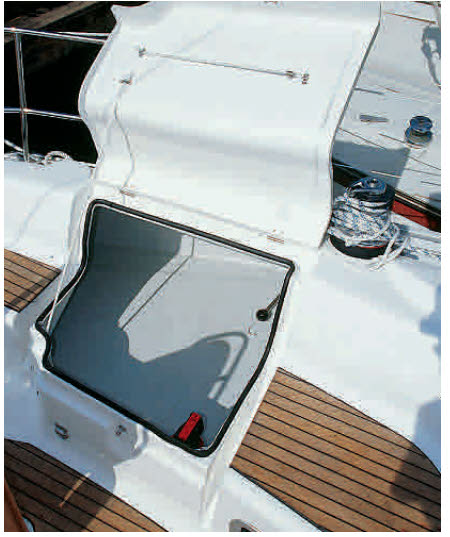

« Reply #3 on: May 12 2015, 13:42 »
Just one on each lid. I'm on the boat at the moment, so I've just taken a pic with my mobile, not great quality but should give an idea.

« Reply #4 on: May 12 2015, 15:21 »
thanks for sharing picture, very useful.  Your teak work looks great, what are you using on it?

I am coming back to my original question.
The picture above from the new Bavarias shows that they have a straight and rectangular lid, while my old ship has that curvy lid.
It also includes the back rest and coamings. It's not easy to find the right fixing points for the strut.
Maybe someone already did all that.
