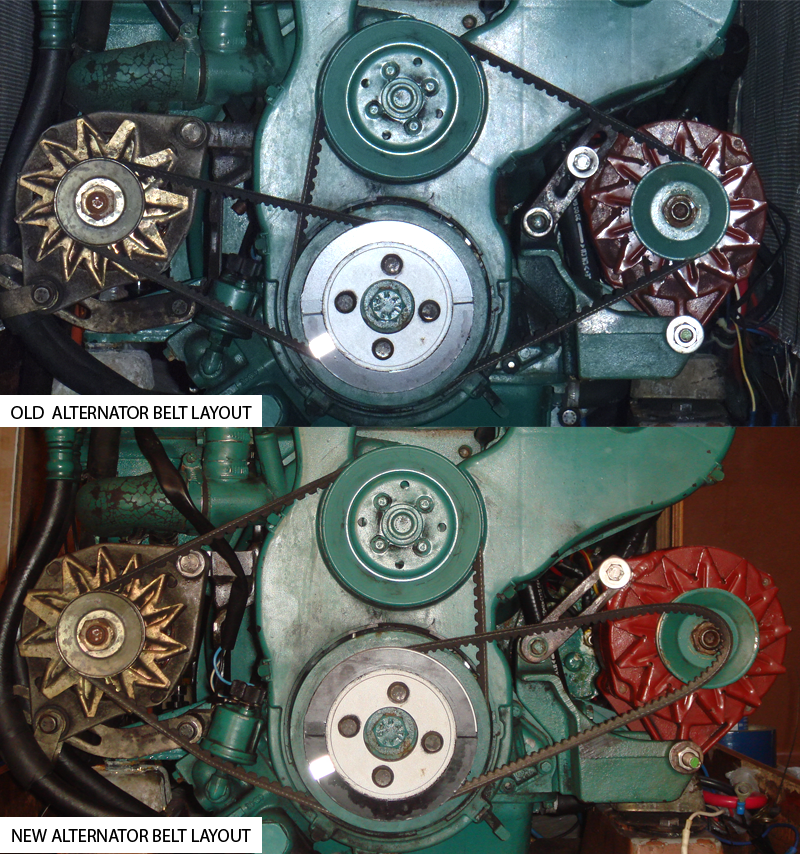

I've just changed my Alternator Belt Layout, see picture:
Reasons for doing this:
The 12V alternator (on RHS of picture) is 120A, and gets through (9mm) belts quite quickly. The other belt (24V alternator) has not been changed in 10 years.
The load on the 12V belt was increased by being shared with the water pump.
The new layout reduces the load on this belt, and increases the wrap on the pulleys.
The drive spindle is now slightly smaller, so again this should reduce slippage.
Now I need to measure for new belts:
I was thinking of using some 3mm string with the alternators where I want them to end up, will this work?
How much movement of the pulley should I allow to fit the belts?

You cannot measure with string as it will sink into the v of the pulley. Ideally use an old belt as a tape measure. Try and find either one long belt or else join two short ones so you are left with a length of 10mm belt which can overlap at a convenient point. You can then lay belt flat and measure. The correct belt will be a 10x whatever the length you need. Belts are normally measured from the outside, example 10x1250 (mm) I think 25mm allowance will do depending on free space around the the various pulleys.

The 24V alternator was fitted from new. Volvo Penta do a kit, this is the one for my MD22P.
I cut large chunks out of the mounting bracket, not knowing it cost £500!
