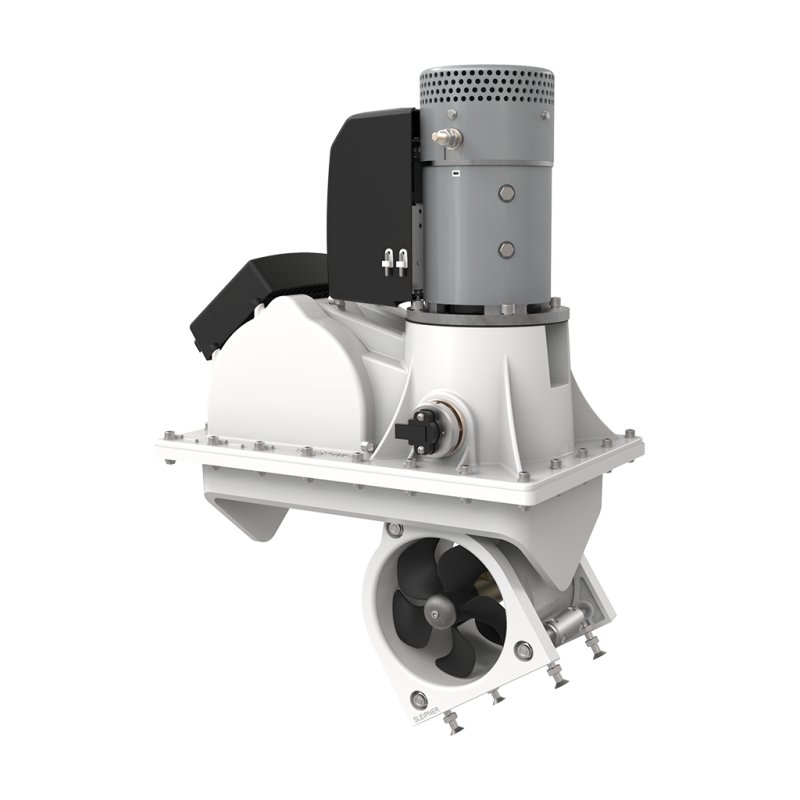

I do not know which model of thruster you exactly have, however googling "Side-Power retractable thruster" gave an image like this:
The grey towering-thing is the brushed DC motor. I don't think having carbon dust outside the motor housing is a normal occurrence unless there is an underlying issue.
