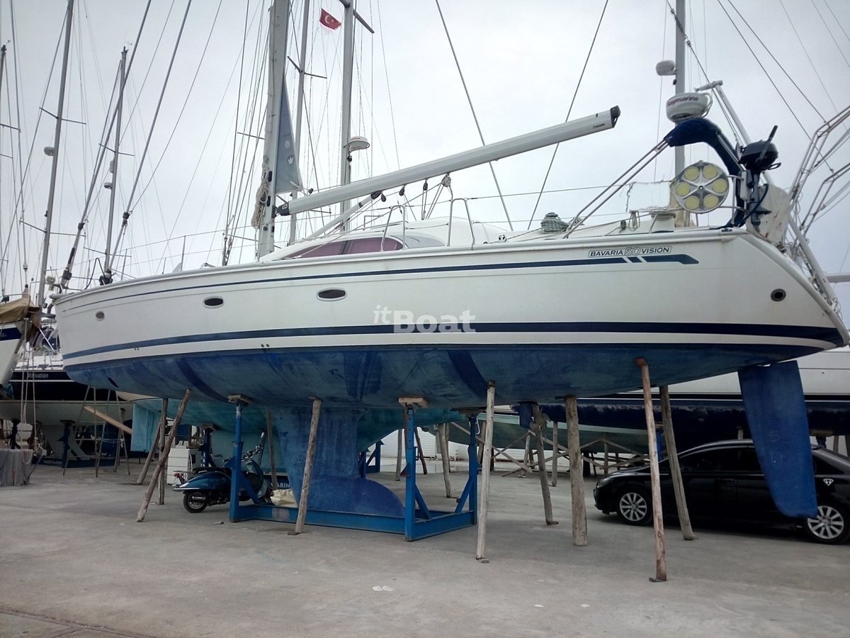

We have replacement from Bavaria, which has been fitted and is at exactly the same angle to the hull as the old one, but I have never thought it look right (very vertical, rather than staked slightly aft as most rudders are).
Would anyone have any pictures of a 50 Vision ashore that I can compare?

Image search provides: https://itboat.com/uploads/55b9/0aa0bcaa1377.jpg
There's however no way to fit the rudder at the wrong angle. The new rudder comes with the post embedded. The post goes in a hole top and bottom, unless either hole has moved, the rudder is in the only place it can be.
So if it's different, it must be because the rudder itself is built differently. Which is quite possible.
Does it matter? Probably not much! :)

Yes, that generation of Bavaria designs had vertical rudder stocks. It was only the next generation with a different designer (Farr instead of J&J) that aft raked rudders were used. Vertical rudders are perhaps more common across the board than aft swept ones.

Looks perfectly fine to me. You want to rotate the boat around an axis perpendicular to the waterline and this rudder will do a perfect job :-)
