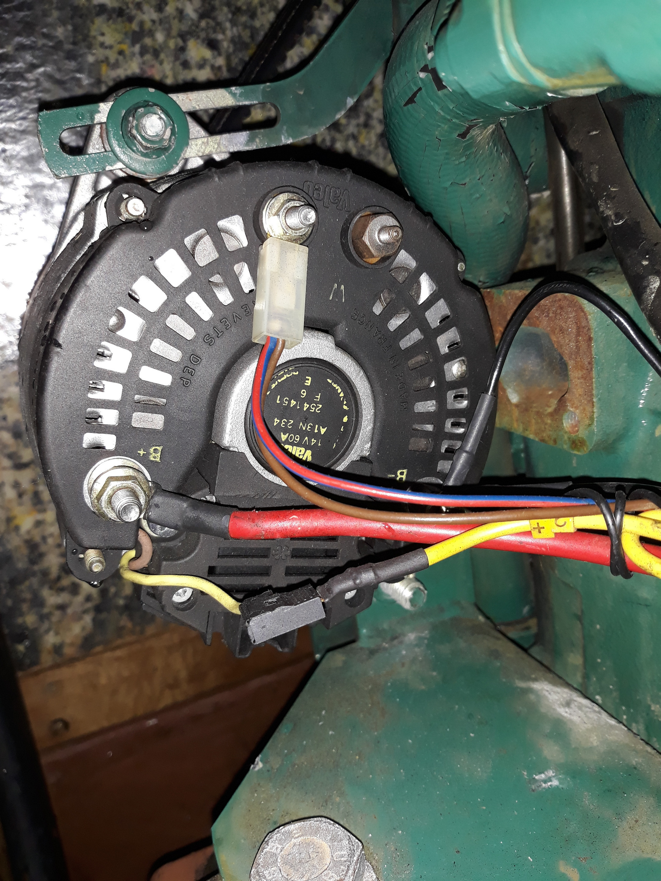

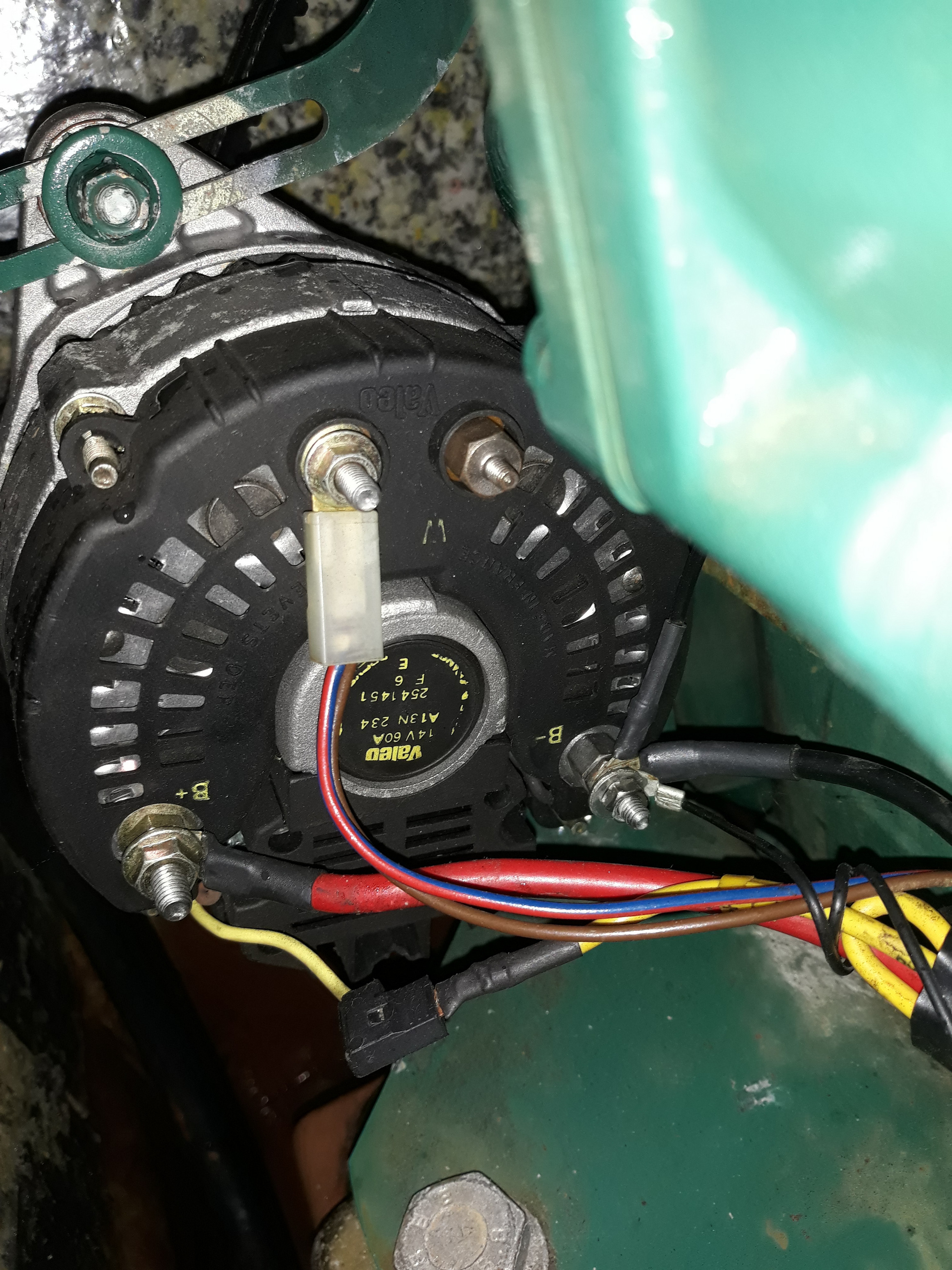

I would like to kindly ask for some wiring advice or/and shematics for Alternator wiring since what I have connected on alternator is what is seen on the pictures (maybe mechanics did not wire things up correctly). They removed and isolated cable for split charging (since I charge only engine battery from engine and engine battery is charging Lithium bank through B2B charger). I already changed battery to new one :)
So only connections which I have are B+ and B-. It is obvious that at least two wires were connected to D+ but lenghts do not match in this configuration, but it might be changed by mechanics?.  Can someone please explain those to me and wether I shall connect them - or what to measure.

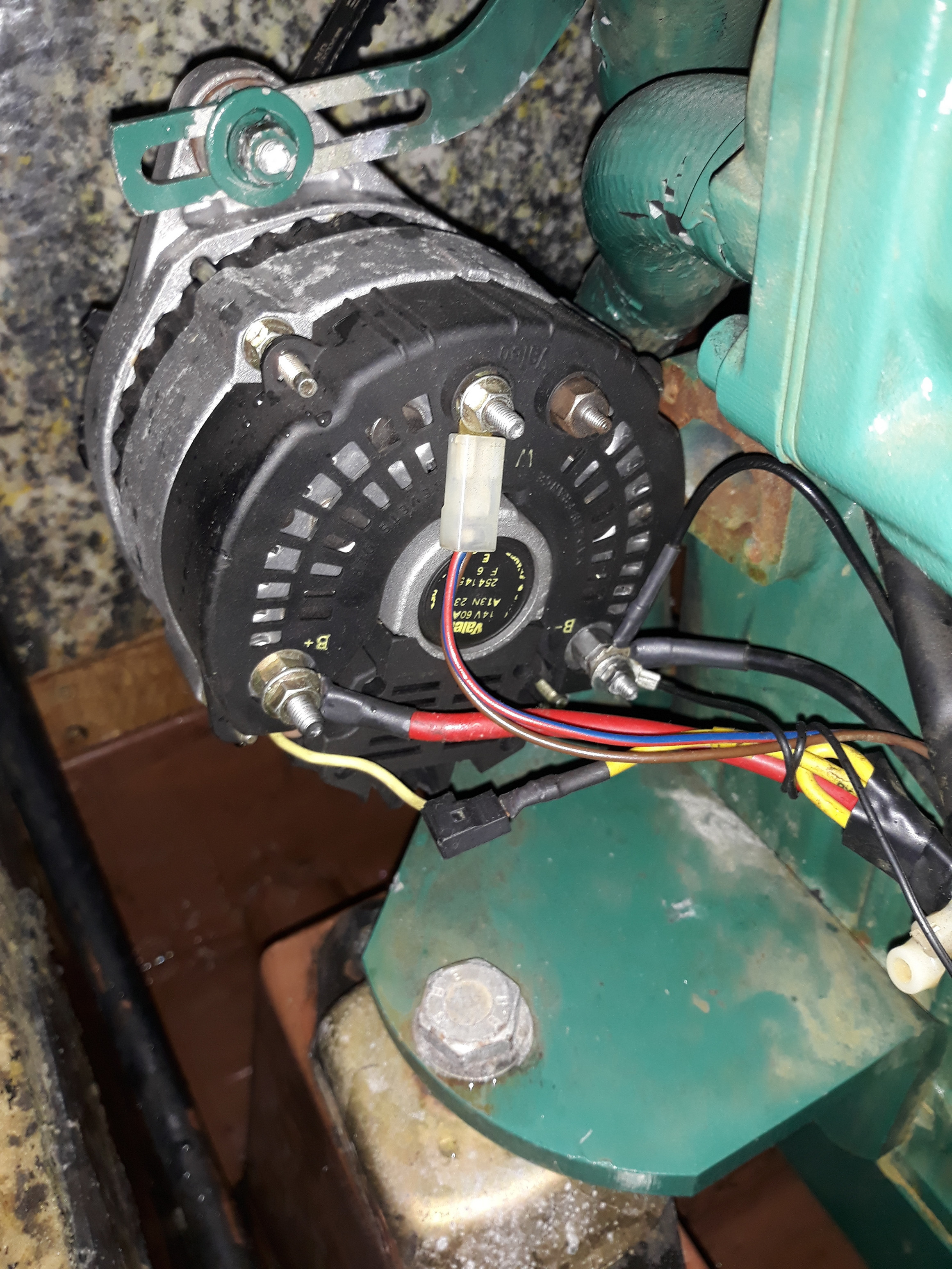

All wiring seems to be original and not much changed, except I found out two wires being put together by hand and are free like it is shown on one of the pictures ... not a pro solution from a 10k €+ engine refit bussines...

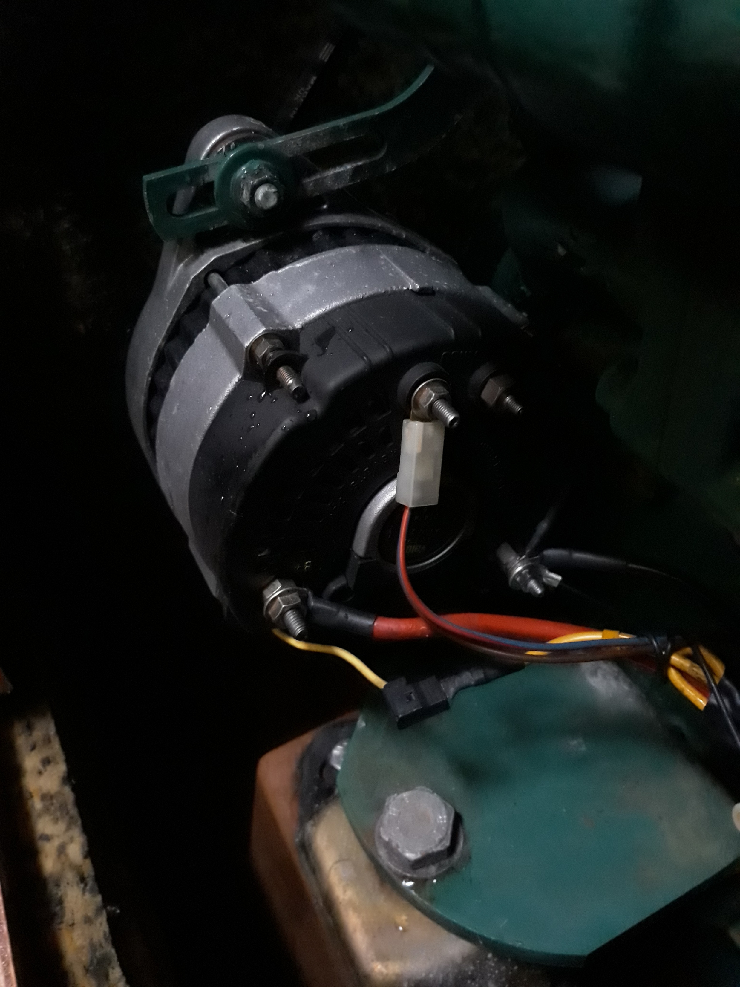

I have changed the original alternator on a D2-55A (Bavaria 44 2003) to a newer type (claimed to be a 100A one) , made some pictures before I started to change. It might help you to identify the missing connections. The colours of the wires should be the same. What I see are two wires simply cut off, a brown and a blue/red and they should be attached to the terminal #61 (on the top besides the "W"). Other thing is the yellow wire, probably the voltage sensing wire coming back from your battery and it should go the the short yellow wire coming out of the alternator - short-cutted to the B+ on your alternator. The last mentioned shortcut cannot cause overcharging, the yellow line from the battery is there to compensate losses while charging.

THANKS, I will wire it this way and see :) Not worried about yelow sensing wire since I only charge starter battery with alternator and B2B chargong lithium if needed - but have 700+ of Solar + hydrogenerator so practically do not need engine charging at all.
Do you possibly know the functions of these blue/red and brown wires? (Just to understand what they do:)

one wire goes to the rev-counter meter, the other wire to the warning light...
I would connect a normal voltmeter to Plus and Minus and check the charging voltage at 600rpm, - it should read something around 12.x V then go up  to 1500 revs and up, it should read something up to around 14,3V.   The voltage should not go over 14,4 or 14,5 V, the rev counter should show the correct motor rev and the warning light should not light.  And nothing else should be active as you measure - like solar and Co.
If you do not need the motor to charge your batteries I would cut it off from the house batteries - if something is wrong the alternator can still destroy them by overcharging with too high voltage. If the voltage is Ok like not over 14,4V then it cannot damage your batteries, they take what they need, if they do not need charging they do not take it, they "float" at 14,4V. ( all this is for lead-acid batteries...)
