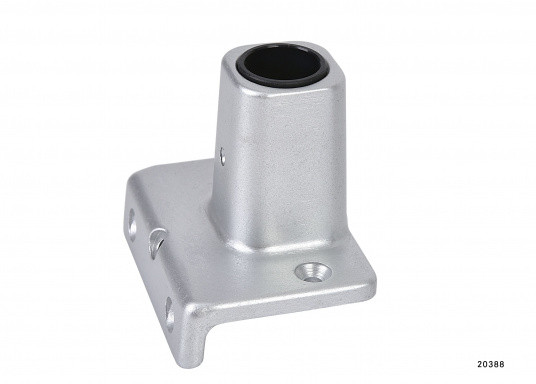

I have a leaking problem with my Bavaria 44 / 2003. Some of the Railing Bases are leaking. Here is a picture of the Railing Base:

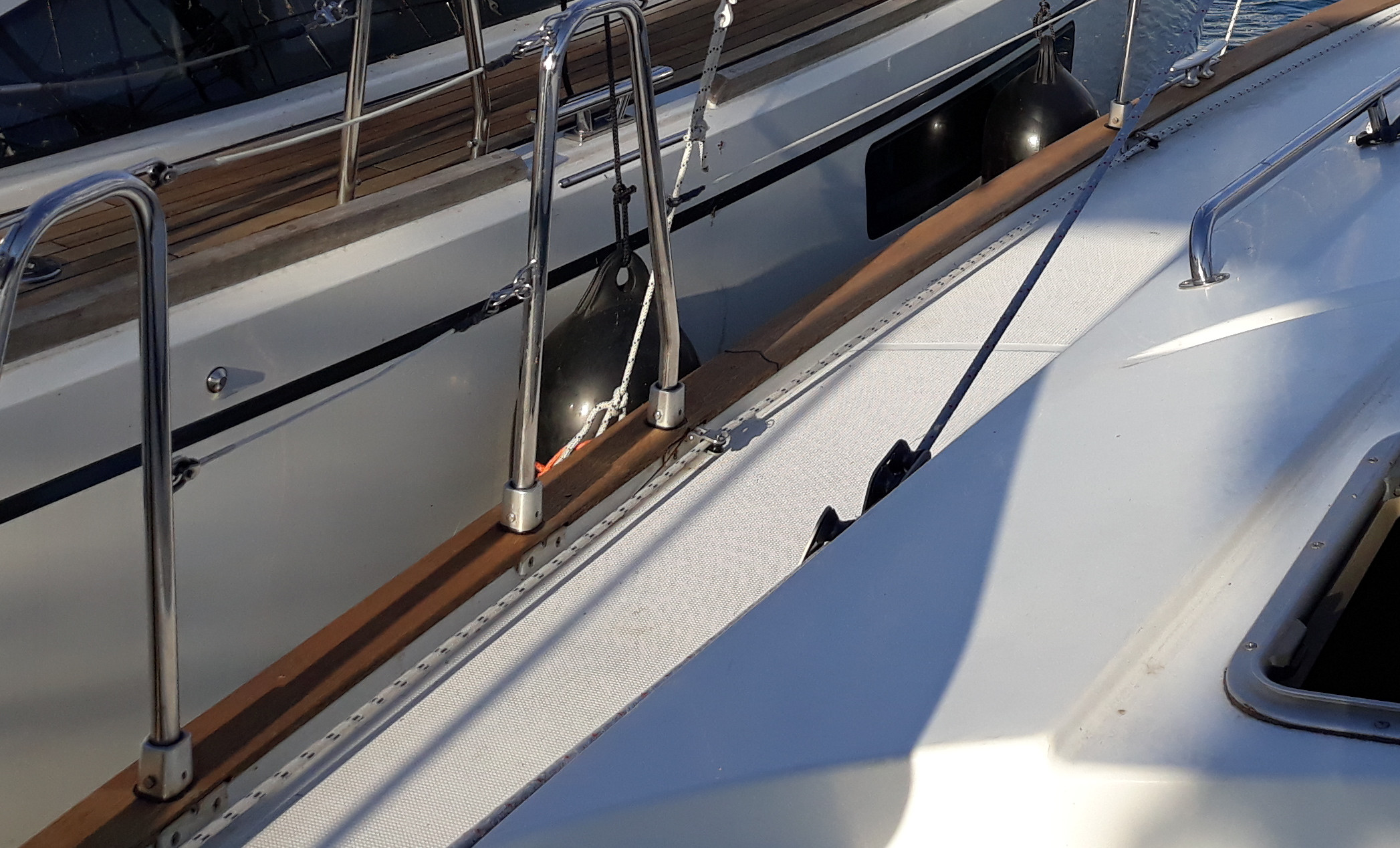

All the Railing Bases are covered with a teak strip:
Everything is sealed with Sikaflex, unfortunately to re-seal the screws from the top it would be necessary to remove the teak strips too.
I am a bit afraid of doing so - they might break, then I would have to let make the whole set again --- $$$$
Is there anyone here who already removed these teak strips from the top? Are they glued to the teak underneath?
I see some screws covered with teak-plugs, is this all?
What layers are underneath? How is the deck joined to the hull? Do I have to re-seal this too?
Another possibility would be to drill two holes from the top for each Railing Base to access the screws from the top, re-seal them and close the hole on the teak with Sikaflex or a teak-plug again.

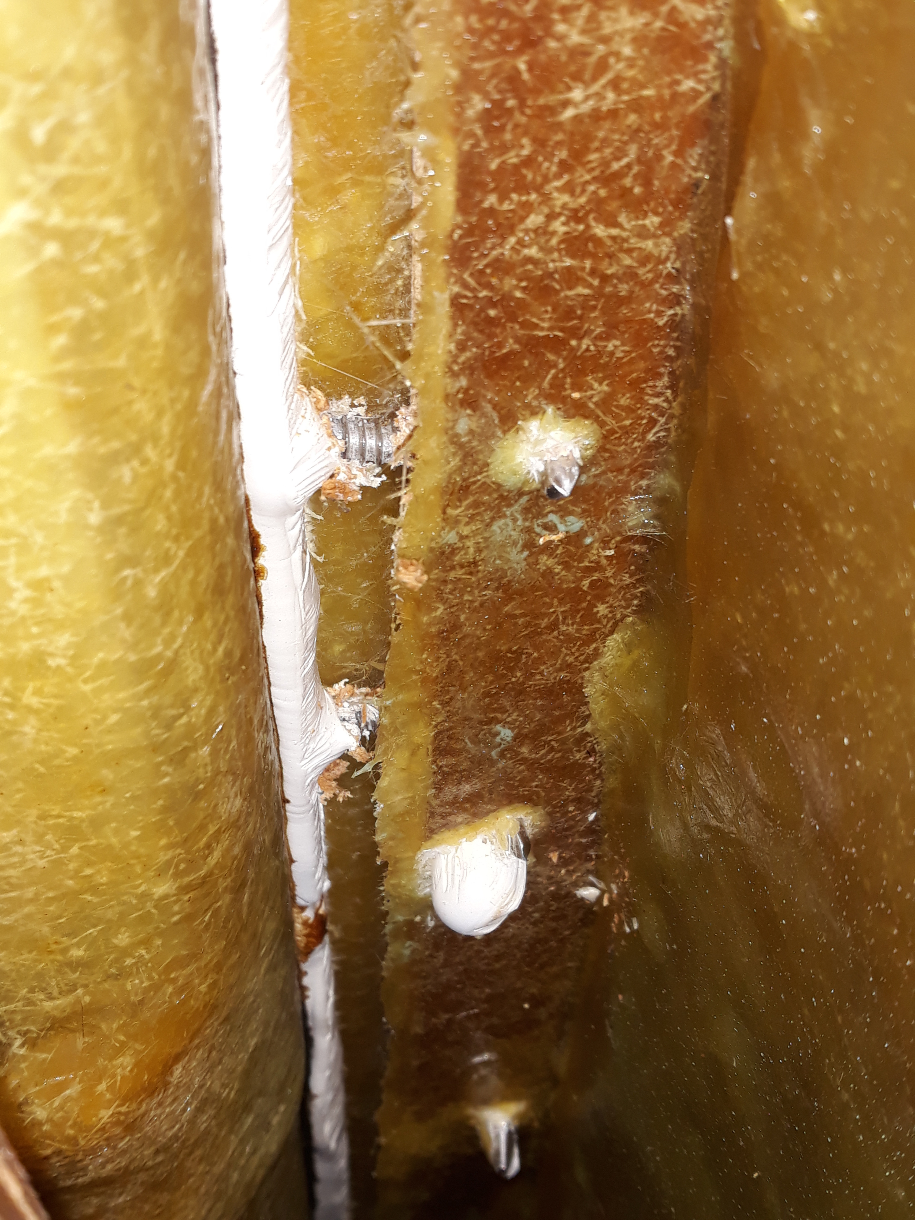

The other concern I have is, that I think there are also leaks in the sealing between the hull and the deck. On this picture the small brown spots could come from water...:
The long white sealing is the one between the hull and the deck, isn't it?

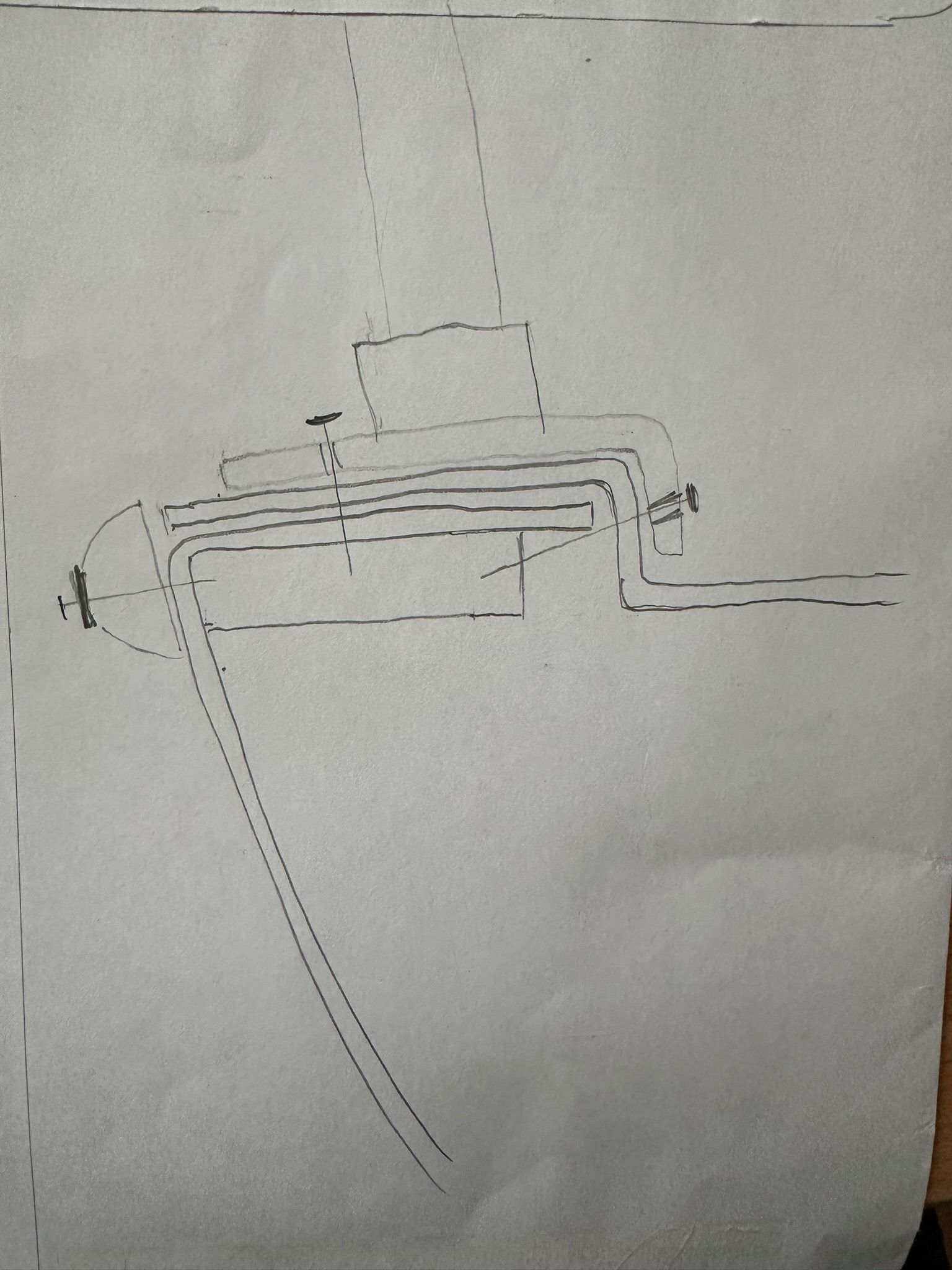

see attached sketch

Thanks, it helps a lot!

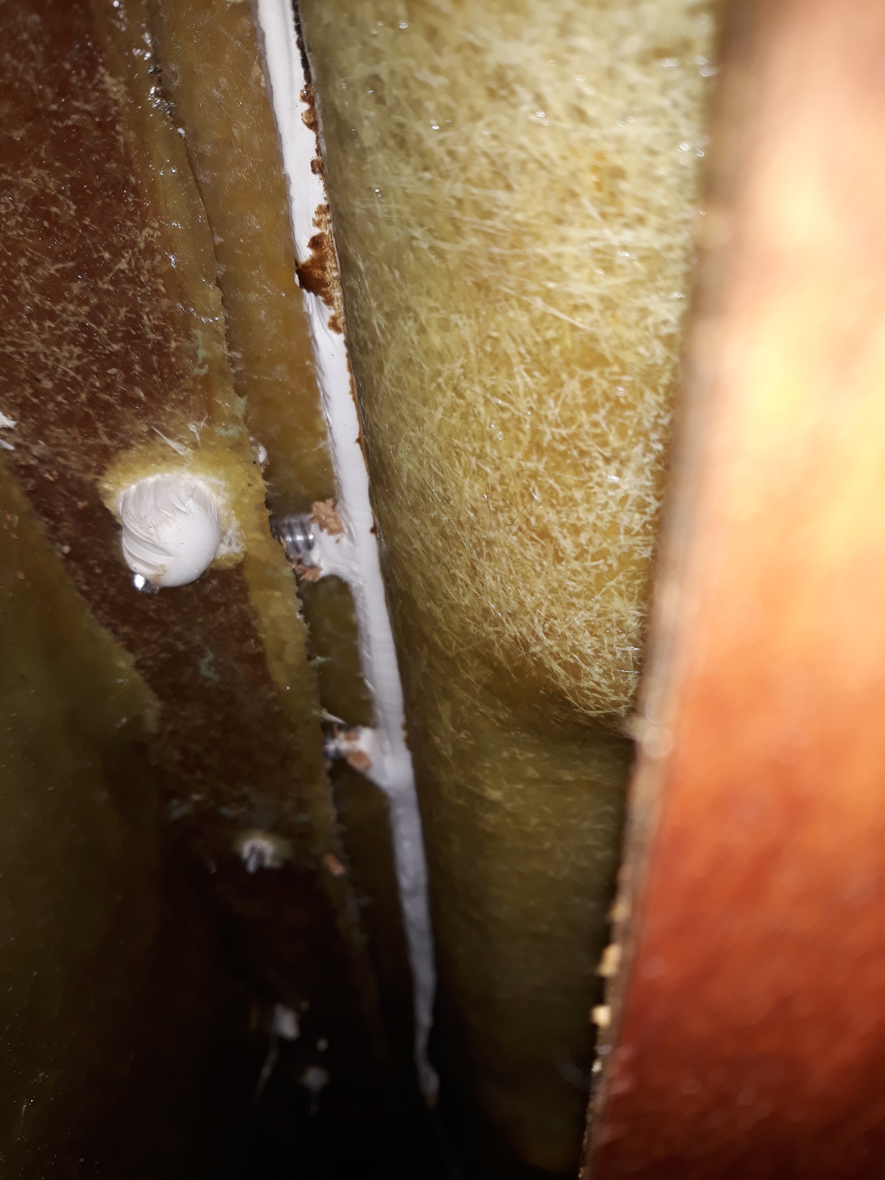

I am tying to understand my picture then, I was thinking that the bigger sealant part (hanging down from the top) was covering the screw through the base.. But it does not make sense this way.
The picture was taken from a side cabinet, camera looking up.
Are you sure, that the hull does not band on the top and goes underneath the bases / teak caprail? It ssems to me that on the top there are two layers of GRP.
Do you have a guess which screw belongs to what part here:
Is there anything holding the screws from the side of the bases or do they simply go through the GRP? Usually there should be something like hard wood to hold the screews... or it is simply the Bavaria-way? It is OK for the first few years, then they should by a new one...
The brown coloured marks could come from the "Nanoprotect Antgra" I am using to protect my teak, washed out by water and leaked into the hull...

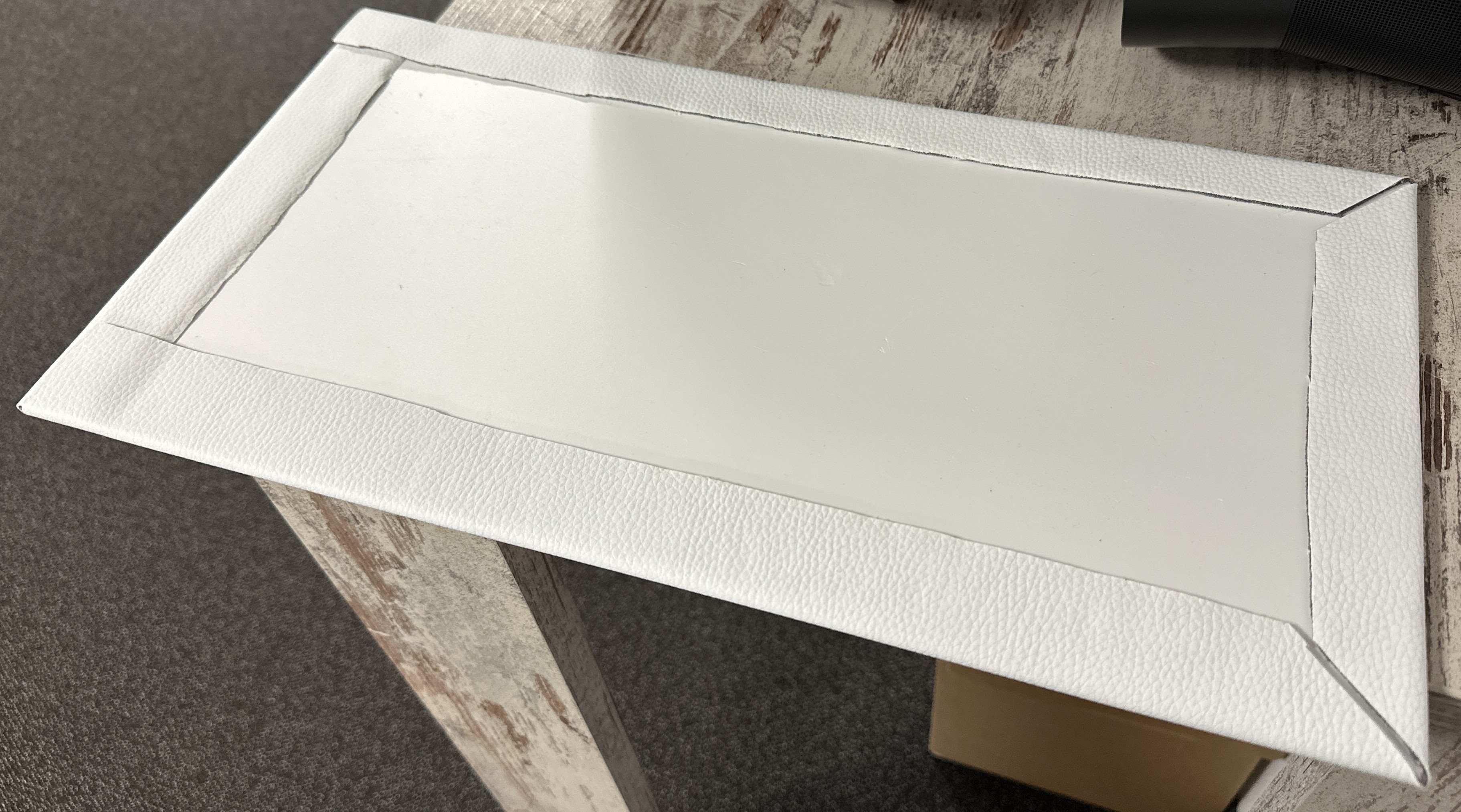

We will try to use hard foam PVC and cover with PVC faux leather imitate.
Test piece
