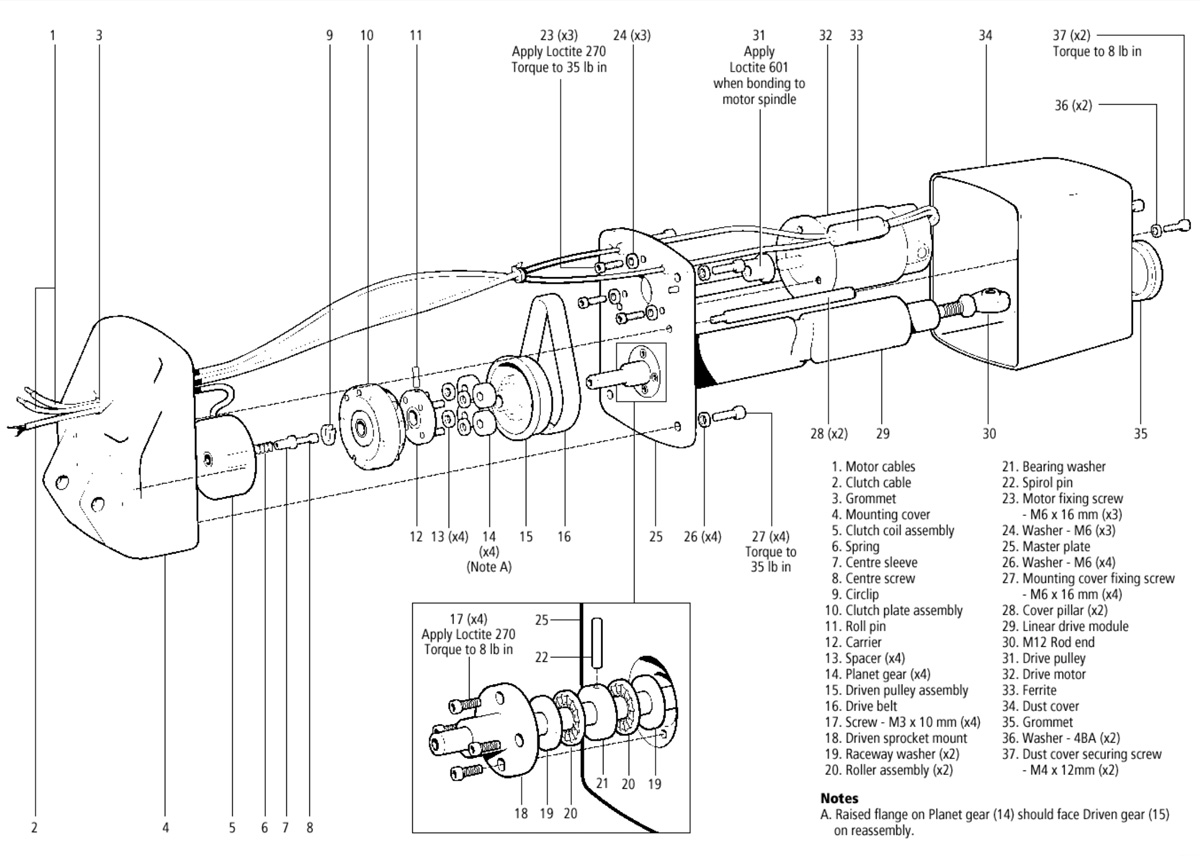

I have a linear autopilot without rudder sensor, that after about 10-15 minutes indicate full rudder to port or starboard. This causes the autopilot to stop giving rudder to that side. This could happen to both sides. The pilot steers well until this happens. I have not noticed anything wrong with the compass heading.
The setup is a Type 1 linear autopilot on the rudder stem, Smartpilot X10 and ST70 panel.
Any thoughts?
Re: Raymarine autopilot - stops giving rudder to one side
« Reply #1 on: April 05 2023, 10:21 »
If it worked before without a rudder position sensor and now it doesn't, then the drive might be slipping. I'd be inclined to take it off and have a look inside and see if the belt (#16) is in need of replacing.

I have opened the unit. The clutch and and belt looks fine.

Test it under load and see if there's slippage anywhere.
Without the rudder position sensor, the autopilot simply counts how long it went left and how long it went right. If those don't add up because the drive is slipping, you get exactly the symptoms you have, where it loses track of the real rudder position because it's not where it expects it to be.
You can also add a RPS, but unless the problem is NOT the drive, that won't solve the issue.
