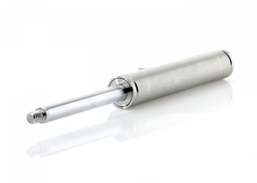

1900kN Gas Spring for Bavaria Cruiser 32 swim platform (and likely larger models too seeing as this is specifically listed for Cruiser 37 also).
I ordered the replacement gas springs from SVB (https://www.svb24.com/en/bavaria-gas-pressure-spring-for-cruiser-32-37-swimming-platform.html) and once they arrived, spent some time understanding how the gas springs would fit into the swim platform hinge. It soon became apparent that the entire hinge would have to be removed to fit the replacement springs, and this in turn would require the swim platform to be removed in its entirety (owing to the length of the hinge mechanism). Given the 'dead' weight of the swim platform, I was concerned about attempting this project in the water (read, "bye bye swim platform") and held back until we had to haul out for antifouling.
Important: These gas springs are loaded to 1900kN. That's a substantial force, especially in an articulated mechanism such as a hinge. It can cause severe bodily harm if handled improperly. My gas springs were completely exhausted, which meant that removal was simple as the hinge could operate freely, but if they had any charge left, this could cause them to snap open or shut. Take care! So where I had the swim platform fully open (horizontal) during the removal process due to the exhausted gas springs, it had to be angled at roughly 60-degrees to the closed position to reinstall it again with the new, charged gas springs in place. In the same way, if the old gas springs have any charge left at the time of removal, it will be necessary to open the swim platform until the locator holes are aligned, then insert a pin through the locator holes (see photos and description below), before removing the screws from the transom.

  • With the two hinges now free, I could pull these out of the swim platform. They were much longer than expected, given the comparatively short length of the gas springs. Then came the head-scratching to understand how to remove the gas springs from the hinge mechanism.
  • I was able to unscrew the piston rod from its mounting by hand with relative ease which meant that I could now lift the piston out of the hinge mechanism (as the mountings can pivot). The cylinder end was harder to remove as the threaded male mounting on the cylinder can turn freely in the cylinder, whereas the female thread on the hinge mounting was well and truly seized. Presumably, I could have heated the hinge mounting (female thread) to expand and 'release' the cylinder male thread mount, but I wasn't keen to bring a heat gun anywhere near a compressed gas cylinder (albeit a worn one), and instead drilled a small hole in the male threaded mount on the cylinder (not the cylinder itself) so that I could hammer it with a punch to unthread it. The latter did the trick and soon the cylinders were free from the hinge mechanism.

  • I fitted the new gas springs into the hinge assembly, first threading the cylinder end of the gas spring into the hinge, and then threading the previously removed mounting on the piston rod end.
  • Then came the difficult part. I aligned the locator holes and inserted a pin through the holes such that the hinge was in the correct position for installation. Then I aligned the mounting at the top of the piston rod end between the hinge sides and clamped the entire assembly into a bench vice. As I tightened the vice, the piston rod end eased into position, and I could secure it using 4x new hex screws. In hindsight, I should have made a video to illustrate this as it's not easy to explain, but at the time I had my hands full and didn't think to do so.
