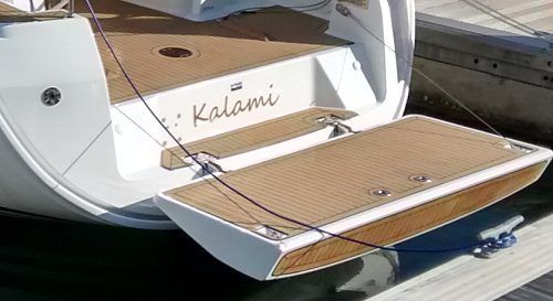

But perhaps you can upload a few pics of your transom to help us poor sods with the old ones see?
There's not much to see, I imagine the gas struts are hidden inside the platform.  Twin stainless wire strops take the weight of the lowered platform.

Re: Transom Bathing Platform
« Reply #19 on: February 16 2015, 05:35 »
Thanks for the pic. That's a really sweet system and great looking stern. Wanna trade?
I suppose one might be able to do something similar using gas struts to replace the motor arms. Getting the perfect size could be a challenge.
I'll noodle on this a bit more next time I have the swim grid down. Thanks again.
