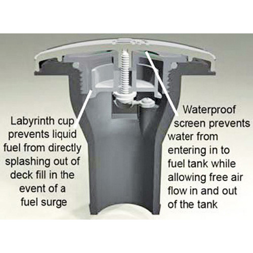

Sounds like someone fitted a vented filler cap, like Perko makes. They do supposedly vent while the cap is on, there is some path for air exchange.
I don't think it's standard, I've never seen it on a Bavaria, the ones from that era all have the Roca filler caps and separate tank vents Tommi describes.
Found a drawing of the Attwood one:
Re: diesel tank venting
« Reply #3 on: September 16 2022, 13:27 »
My B32 2003 has the one piece filler cap. Vents through cap.

« Reply #4 on: September 16 2022, 22:39 »
Same as Moodymike. B32, 2004.
