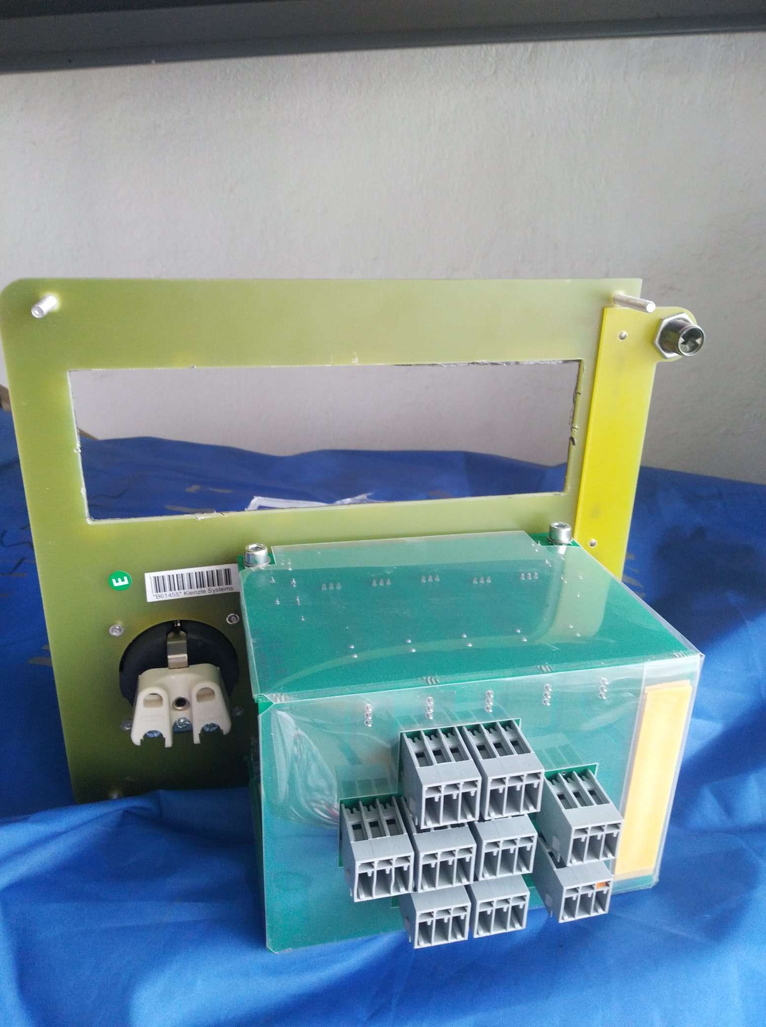

Not sure, does the rear view help? https://sailboat-spareparts.com/gggg/uploads/2022/08/1661521749956.jpeg
Looks like there's studs at the corners, so I'd expect you'll have to stick your arm in there (unplugging the shorepower and inverter first) and finding some nuts to undo.

That's a great picture of the rear of the panel, I have the 301/302 panel manual but it doesn't give any info about removal unlike the pic (thank you). Yes it does look like there are studs.

The panel dismounting is easy. You open left side. You have to turn the screws 90 degrees. Hold this part wide open. Than zu grab in to the back side. Zhou will find a wing screw in every corner. Loosing is no problem but remount is quit tricky
