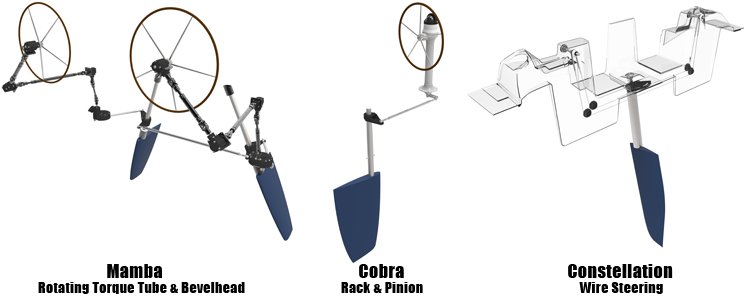

Looks like you bought a bit of a boat puzzle!  ;D
1st picture, you seem to have a Whitlock (now Lewmar) Constellation (not Mamba - see illustration below) steering, with the wheel driving a chain which drives an axle with a sprocket lower. On that sprocket could go a chain-to-wire steering (Lewmar part) that leads aft to the rudder area.

On our 40 Ocean, the setup looks like below image. It's quite possible that yours was different, as our centre cockpit has in-conduit cable steering from an axle under the binnacle in the engine room, but at least you get an idea of a possible solution, which I think would also work with open wire steering. The steering cables attach to the aluminium bracket with the turning blocks. This looks like it may have been in place on your boat, as there are screws in the same place on the step astern of the rudder post. From that, a keyed quadrant is attached to the rudder post. Didn't see a quadrant in your parts collection though.
In your parts collection you seem to have a Lewmar tiller arm and key, which may have been part of the steering, or part of an autopilot driving the rudder post via this arm. There's also some broken parts that look like the remnants of a rudder position sensor, indicating that an autopilot was fitted, so this is likely. There's also some more chain that must fit to the free sprocket, although as it's a loop, it might just be a spare steering wheel chain instead.
Hard to tell more than this from the photos without knowing the exact place everything is in, but it looks like it would be possible to fit wire steering relatively easily. The rudder needs a top bearing first though. Perhaps someone with your exact model of boat can shed further light on what was originally there.

Looks like you have the same system as I do on my 49.  Unfortunately I couldn't tell you what model it is.
You basically have two chains dropping from the wheels down to hubs lower down.  You then have two chains connecting these lower hubs to the central hub/motor.
This is then attached to another big casting which sits behind the motor (I assume is the clutch/gearbox), which then drives the rudder post via a solid link.
I'll try and find some photos for you.
The drive motor looks like this one:-   https://www.helmstock.com/autopilot-drive-mamba-12v.html
There is then a gearbox-type casting attached to the back of it, to turn the horizontal rotation into vertical rotation, which has a solid bar going to the rudder fitting.

The 42, 46, 44, 40 Cruiser twin weels, have an intregrate rotative Lewmar Mamba motor that is bolted to other Lewmar parts as the bevelheads and reduction gearbox.
First of all  ROBBCN must replace these parts  and others minor parts. But where. are upper bearing and upper bearing housing?
After having rebuilt manual system to move the rudder , could relpace autopilot motor.
Now Jefa built modern motor suitable to mamba bevelheds that I think are better than old Lewmar motor.
But I think he need also new autopilot computer and other new instruments.
