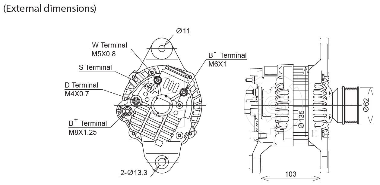

This is for a Mitsubishi 115A alternator.
I have the photo below which shows a very crowded area so I really need to know where the D+/61 for an alternator charge light is and the W for a tacho connection before I take it all apart.
There appear to be plenty of photos on the internet for the alternator but I cannot find one where all the connections are clearly marked.

put in internet search for a new one, then zoom in on the picture for the back of alt, you can see the marks in the casting for the wires, just done it but cant copy the piccy

Have you got the link because ad I stated I have yet to find one that is clearly marked.

From Google image search:
