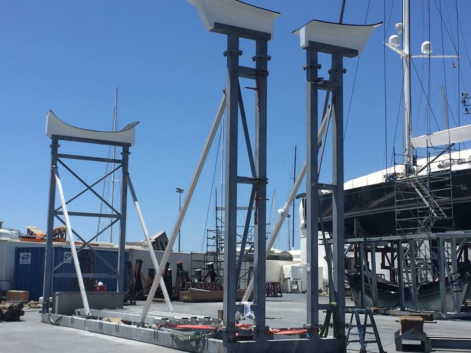

Most yards use cradles because they fit almost any boat, are easy to stack when not used and moved around easily (empty) with a forklift. Some have cradle movers that can haul a boat around while resting in one of their cradlesm, allowing them to pack the boats tighter than is possible with travelift.
If you have a place for your own stand all year around, you don't need an adjustable cradle that fits any boat, only yours. This is easier and cheaper to build and lets you even do useful stuff such as having the keel hang in the air rather than rest on the ground, which deforms the hull less and lets you access the bottom of the keel for antifouling, which is normally not so easy.
Raceboats often have such custom stands and even truck them around when the boat is relocated. They are shaped to fit the hull exactly and must rest in exact locations (where the bulkheads are). Example (the slot is for the keel to pass through):
This one has the additional bonus of folding down when not in use, but that's up to you.

Standing on the keel is the norm for most boats in most yards, and it's okay - the boats are designed to cope, it's just not fantastic, you will see some hull deflection if you look. The custom cradle I showed above where the boat sits on shaped hull supports is a luxury with advantages, but not the norm. But since you're planning to make one for a specific boat, why not - it's easier to build and as you can see, easy to fold flat for transport (sans boat).
There must always be lateral supports while the boat is standing on the keel, but they just keep the boat from tipping over, they do not carry the weight of the hull (unlike the custom cradle I showed above). They can still see significant loads in high winds, so can't be too flimsy, and most yards have ceased the use of single (unconnected) stands due to the occasional boat falling over. Although in one Tunisian yard they still used barrels and logs and whatever scrap they had laying around when our friends hauled there :)
