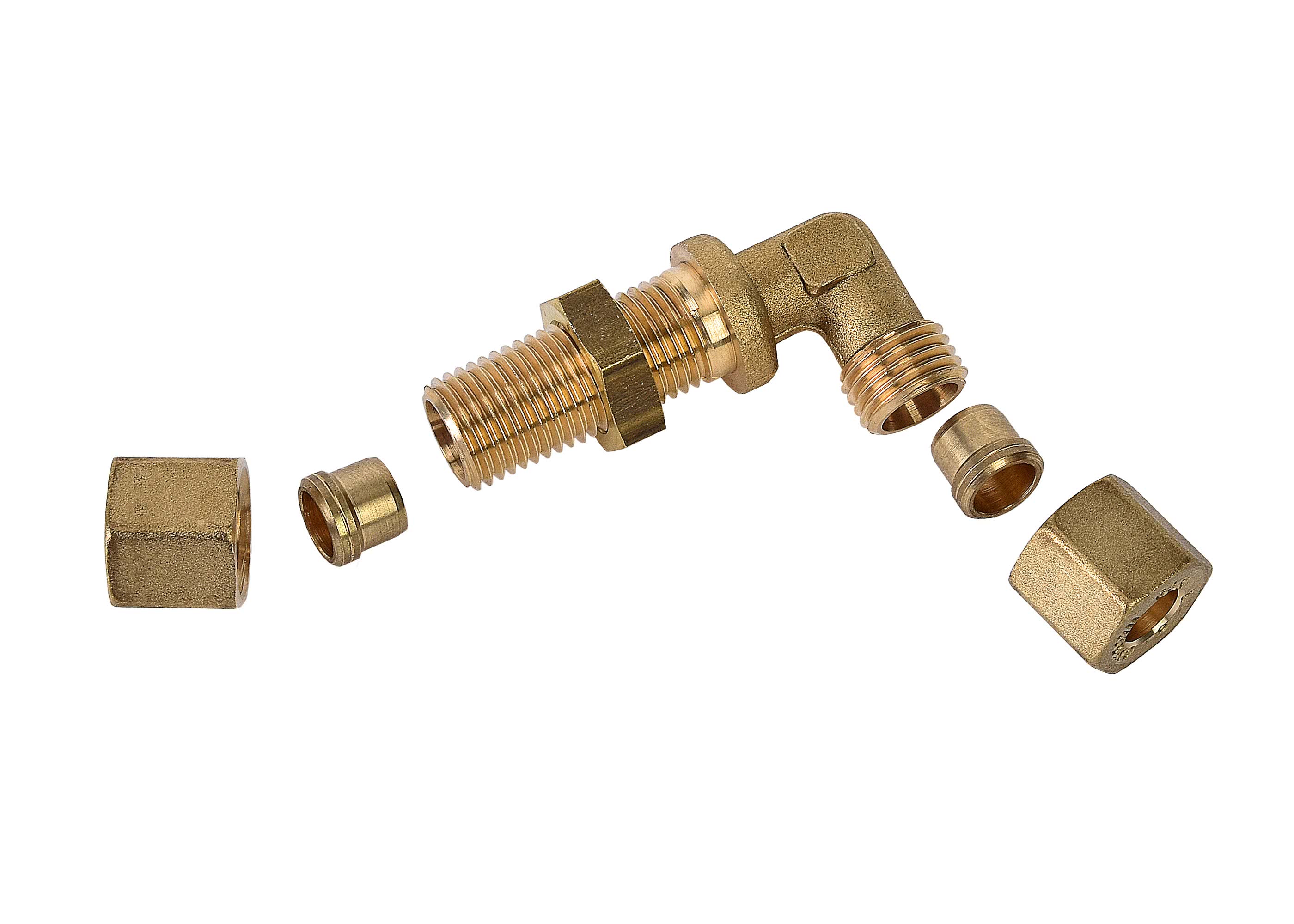

Re: Gas Regulator
« Reply #12 on: June 09 2022, 10:13 »
If below picture is your bulkhead fitting, then it's the other left that should loosen it  :D
Re: Gas Regulator
« Reply #13 on: June 09 2022, 11:14 »
If only the Bavaria fittings were brass like your illustration, they appear to be steel and seize over time . I had to cut mine off the cooker joint

Concerning the question of left- or right handed tread:
Under german gas installation  rules, under which Bavaria boats are built, following is applying:
If the nut has a notch, it is a left handed thread, otherwise  a RH thread. See marking circle on attached photo
