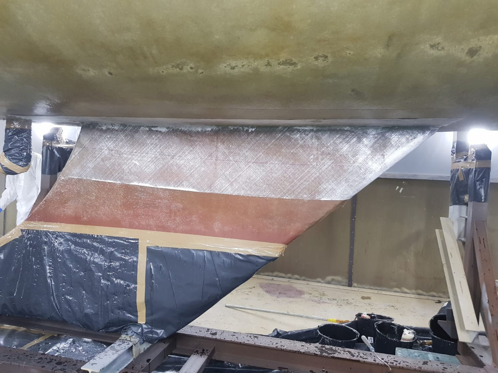

« Reply #7 on: June 07 2021, 15:45 »
Hello,
back again with good news:
Boat is in the water and we had already some tryout with the closed lateral plan from keel to the leg of the saildrive. It works.
There is now no fluttering on the prop, nor saildrive, nor the powertrain when turning the prop into sail mode.
We made a short video, and we tried to observe the circumstances under water with a UW cam. We went through the cockpit draining holes with a cam stick and came out of the hull 60com behind the prop. A Go Pro you cannot hold in 2m depth while sailing with 5kn speed. Already when our camstick came under the hull more than 10 cm, the stick began to vibrate. Nevertheless, the vortex shedding theory seems to be right.
If you want to see the video and the complete story, you can find it on our webpage
https://www.skokie.de/ocean-40/strömung-kiel-saildrive/
https://vimeo.com/558991981
Thanks to all for help, thinking and recommendations
