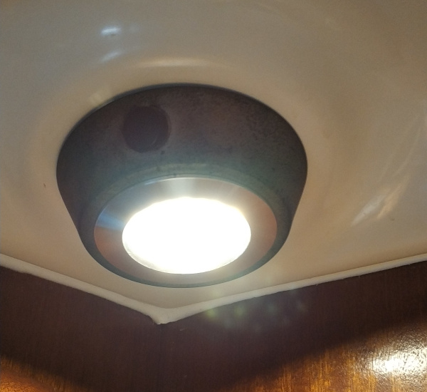

I have been looking on the Web for the LED Cabin lights in the attached photo by Odysseus but have been unsuccessful, if anyone has a link, please post.

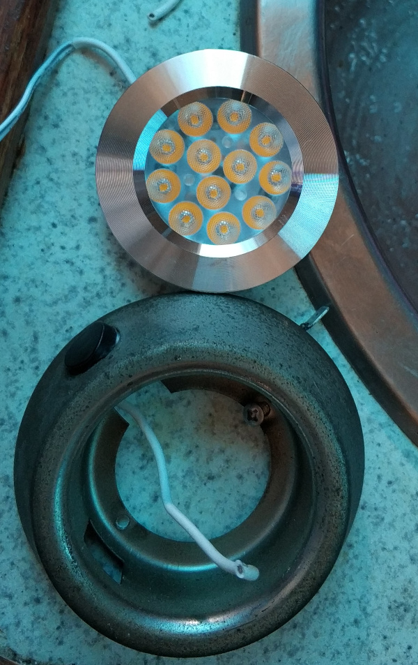

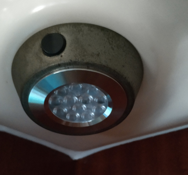

I replaced the original halogen lamps with these LED sets. They fit right into the original compartment and with a little bit of fiddling, they stay in. It was easy to connect them to the existing wiring in the cabin. They are of much lower power consumption and shine very bright at night. Once installed, do not rotate as the original ones did. Using the same wiring, I got USB adapters/chargers to fit right next to each light, just for the sake of convenience for cabin occupants.

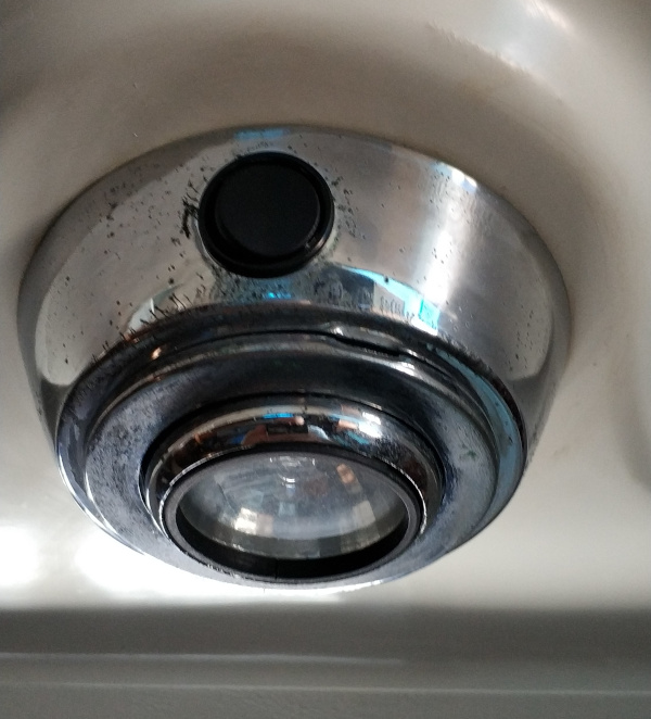

The stock light fixtures divide into the inner element, that you remove with a flat screw driver. Then replace with the LEDs, and the outer housing that stays onto the boat.
These LED lights fit right into the fixture. So you get to keep the original mount and the switch.
In retrospect, it would have looked nicer if I had the mounts rechromed, they are easy to remove.
Re: Cabin LED spot lights
« Reply #12 on: February 18 2021, 09:50 »
Use WD40 and baking aluminium file it, will come up like new.
