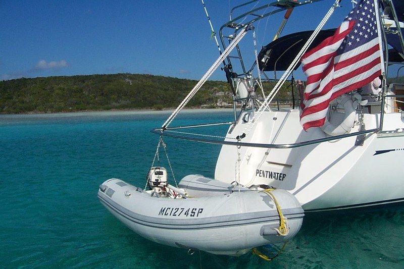

I've got a fairly flimsy arch standing on the pushit and separate davids on deck of Ocean 40. Not a setup I would recommend: the davids on deck hamper available space and moving through stern.
If I was to make a new arch, I would for sure want the davids integrated with the arch as you suggested. It would also be mounted on the toerail and not on the pushpit and it would be made of around 40x2 mm pipe so that it would be strong enough to climb on.
One option would be to have the dinghy lifting as one extra arch, hinged from the lower corners of the arch in such a way. With this setup the dinghy moves aft when lowering and forward when hoisted which would be good. And if the dinghy is not on the arch, nothing is protruding aft. But I have no experience with this type of setup - just a though...

I’ve fitted an arch partly on the transom and partly on the deck outside of the cockpit area of my B36(2002) using the 40 x 2mm stainless tube, and can confirm it is strong enough for me to climb up the sides, though I have not attempted to go across the top. It is great for mounting PV panels and also my AIS transmitting and receiving aerial. I have toyed with the idea of being able to hoist my dinghy onto it and have tried just fitting a couple of pulley blocks to the aft rail that lift the dinghy sideways up and out of the water. But this set up blocks my view astern which I’m not happy about such that I don’t use it. However the system shown in your picture at the above web address looks very interesting as it takes much of the weight of the dInghy away from the arch, transferring it to the hinge arrangement at deck level. I’ll give that some thought as a possible alternative, thanks.

Yes, it is a benefit that a part of the load of the dinghy is on the deck and not on the center of the arch. That said, a 2.5 m wide 40x2 mm arch having two horizontal tubes should be able to take a load of 100 kg at the center of the arch, which should be fine for a small dinghy. From my point-of-view, one of the major benefits of the hinged system would be that there's nothing protruding aft of the arch and that the dinghy is naturally lowered down and away from the boat and up and into the boat.
