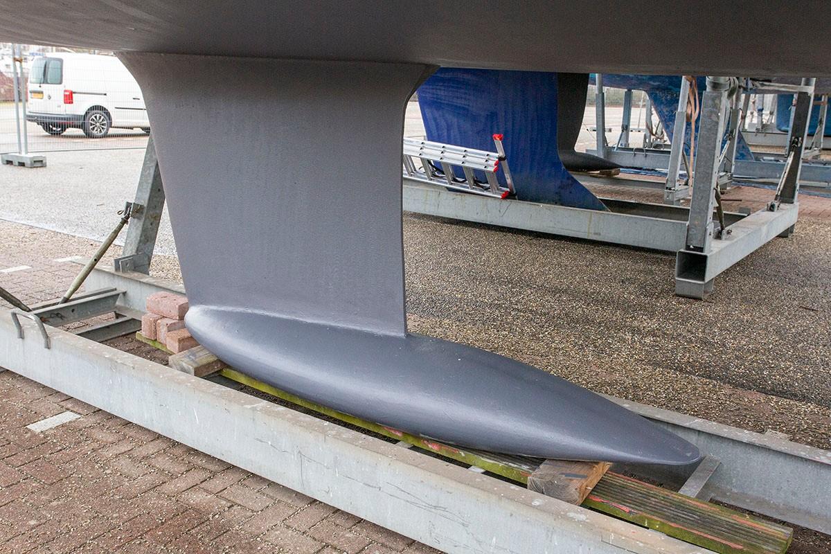

Is the standard draft really only 1.8 m, with a one-minute googling could not find any alternatives for Vision 44...?
Re: Taking a Vision 44 offshore.
« Reply #9 on: June 15 2020, 12:42 »
There were two keel options. The shallow one which the Dutch boat has with a long bulb at the bottom and a deeper one (2.2m) with a shorter bulb. The one in Portugal has the deeper keel. I think they are both lead. I expect the righting moments are much the same, but the shorter chord length of the shallow keel may have a small effect on windward performance. You can see photos of the keels in both sets of particulars.
Thanks for the info. Interestingly there's several ORC-certificate of Vision 44 with 2.0 m keel but no certificates available with a shorter keel or with a 2.2 m keel - perhaps the deep keel is actually 2.0 m...? I think "a small effect on windward performance" might be a bit relative term as I think going from 1.8 m to 2.2 m would increase the hydrodynamically effective keel area by about 50% affecting VMG fairly significantly when going to windward. Especially for offshore sailing, I would personally exclude the 1.8 m keel option if deeper ones are available...

Draught of the Vision 44 is 1.82m (shallow) or 2.18m (deep) from the datasheet. Never trust broker details, they're notoriously incorrect. I'll upload the data sheet to the download section shortly.

The Dutch Vision 44 has the shallow keel. Easy to distinguish because of the ballast "torpedo" on the bottom:
Yes, I agree. That is a keel shape J&J used on other shallow draft models like my 37. The boat in Portugal has a keel that is more like the later Farr boats. It does, however look very bulky for it to be the same weight (as the data sheet implies) if it is lead.
