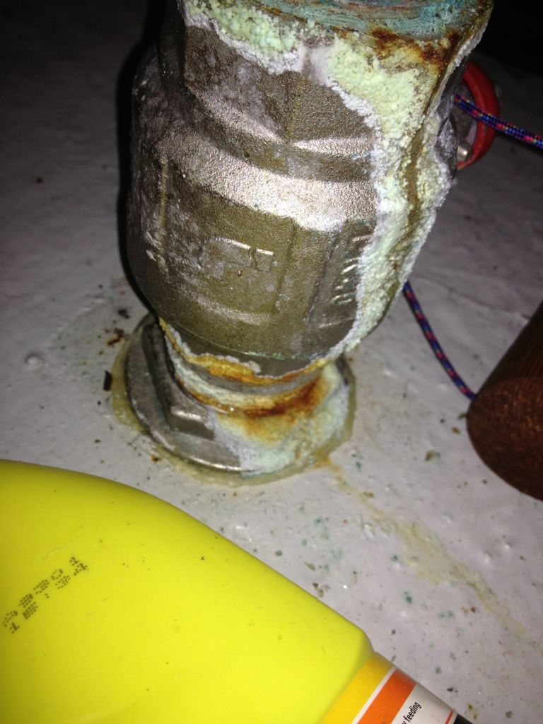

What are your thoughts on this seacock?
Author Topic: What are your thoughts on this seacock?  (Read 8470 times)
  • Posts: 85
  • Boat Model: Bavaria 37
« on: March 06 2013, 10:34 »

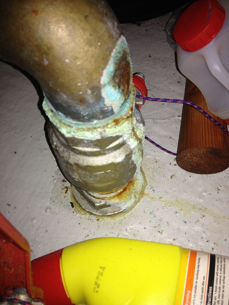

Do i need to be concerned/replace it? ( On my 7 year old Bavaria 30)
Ripster
  • Posts: 135
Re: What are your thoughts on this seacock?
« Reply #1 on: March 06 2013, 17:39 »
The thing with a fitting like that is that its prob not the valve itself that would fail (dezinc enough to become weak).  Its far more likely that the threads on the skin fitting which is the thinnest part would fail first or the threads in the tails.  It is extremely difficult to tell condition from the outside like that, so if it was mine, on next lift out, I would dismantle and inspect for pinking and if in any doubt, for what they cost get a new DZR set from ASAP supplies and replace.
