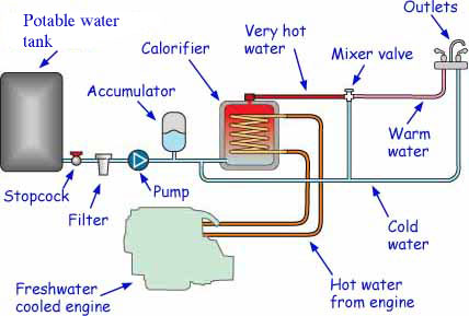

To avoid filling the whole calorifier with antifreeze, I drain The calorifier and connect calorifier cold input tube directly to hot output, thus bypassing the now-empty calorifier.
Thus enables me to fill hot water plumbing and hot side of taps with antifreeze.

Thank you, that diagram is very helpful indeed. As is the tip of draining down the calorifier. Do these Bavaria's have a water filter built in somewhere? If it does exist, where is it and what sort of element does it need?
