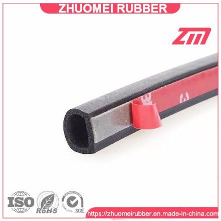

This seal? Dimensions are in the photo. Will replace again this year with a D-profile compressible rubber seal, as the one from then is getting a bit old again.

This sort of thing:
Haven't done it yet, so no idea how well it works, but hopefully well!
