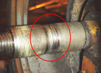

Did you inspect the shaft? The shafts tend to wear where the seal rides on them, and once they do, the seal won't seal no more. You can either replace the shaft, sleeve it or sometimes seat the seal differently so it rides on a different part of the shaft.
Example picture from image search: http://avtokomtg.com/images/articles/iznos_vala_nasosa/iznos-vala-nasosa.jpg

Yngmar,
            The shaft showed little sign of wear.  I was thinking that the seal may have "dried" over last winter.  Should some sort of lubricant be needed?  From memory the seal was quite a tight fit and i pressed it home using a long socket.  It was sealing fine for a whole season then failed early this season.
If I've got this right, there is a spinning shaft trying to seal onto a rubber seal with only water as a lubricant. Or am I missing something?
