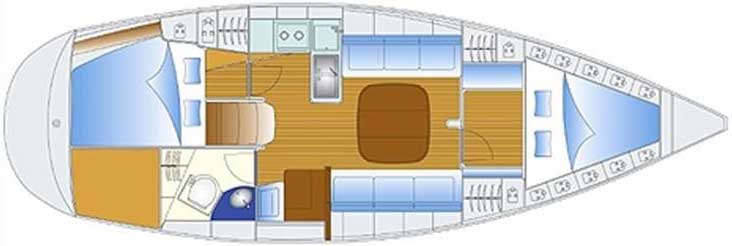

I'm trying to work out from the Bavaria diagram where the holding tank should go from when fitted as new, the plan suggest that it goes in a the small gap inside the hanging locker - but it seems rather a small space, failing that it could be the bulkhead in the lazarette. Anyone got a photo of theirs to hand? It may be that I have to rip a wall down to get it in (but hoping not!).
My boat:
And the manual for my boat which is not the same as the diagram which shows the holding tank position.
(see below)

I'm just finding it really odd that the owners manual diagram above (which is the same as the one I possess on the boat) is so inaccurate with regard to the shape of the heads. Having said that - the galley is different to the plan and so is the table in the centre of the saloon. I'm wondering whether the diagram is for a different size model.
