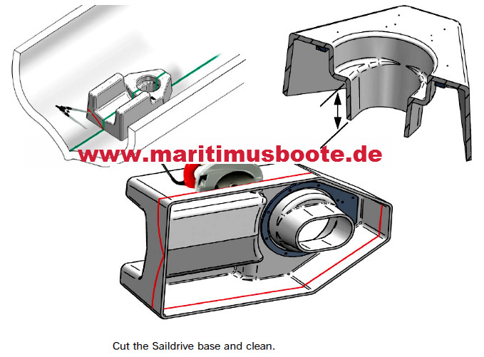

Nothing, the saildrive base/engine mount is a simple GRP moulded piece, open at the bottom, with the nuts or a ring with threads for the saildrive glassed in. The mount's "skirt" is cut to match the hull shape by the installer and then glassed on, creating an empty void between the base and the hull. Only once that is done, the hole for the saildrive leg is cut through the hull.
