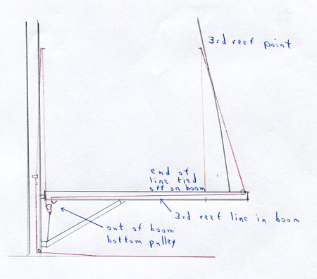

This is how I have done it - and used it successfully  :o
Re: Selden Boom - 3rd reef?
« Reply #3 on: October 09 2018, 16:06 »
Thanks Dawntreader, I thought it was just my boom where the sheave was missing, but your diagram makes it very clear how to rig that third reefing line.

« Reply #4 on: October 10 2018, 07:40 »
I forgot to mention that not all sails come equipped to have 3 reefs and mine was modified accordingly. Also, in answer to the question, the end of the (3rd) reef is tied off around the boom as are all the others - nothing mechanical added  ;)

Thank you all, I confirm that the 3rd reef does not have the sheave installed - so I will add the turning block as per the diagram, also tying off the reef to the boom with a nifty bowline around the boom.

I've amended my drawing to include the running bowline  :P
