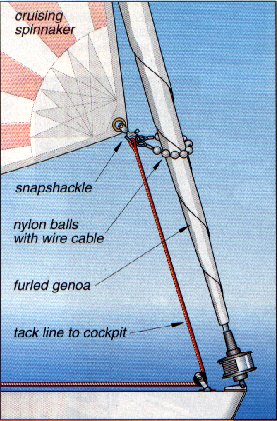

- a DIY ATN tacker and lead the tack line via a block fitted to the forestay bracket back to a cleat so it can be easily adjusted
- Just a block on the forestay bracket, try flying the cruising chute in light winds to see if it catches on anything, i think if i led the tack line inside of the bow seat it would not foul anything, again back to a cleat
- DIY ATN tacker and stick the block on the stong hold like this:

I have just purchased a chute and an ATN tacker and like you am adjusting boat to fly it. If you use a atn tacker the eye bold you have circled I would think would be ideal to take the tack line block.  I don't have that eye bolt and am considering if i need it. My initial plan is to fly from the bow roller which several have informed me is man enough for the job.  With the atn tacker the chute tack flys from the tacker itself which is set above the pulpit so no interference with nav lights or pulpit parts. The tack line can be lead to a block aft of the fore stay as shown in your diagram.
Regarding sheets I thought about 8mm but have gone for 10mm (22m/sheet).  I choose the 10m as it will be easier to handle and a better fit to the winch.  I know there is a little extra weight but really if there is not enough wind to cruise in light airwith 10mm sheet and a big chute then the engine needs to be on.  I also always plan to gybe the chute outside so lazy sheet needs to be extra long.
I am also planning to put two deck eyes aft to take the sheet lead blocks for the winch.  I thought about strops to the aft cleats but on the B34 these cleats are almost below the winches so the lean angle would be rubbish.

Yes have seen the fender development of the atn.   By the way there are some good video's online showing setting up and gybing the ATN (and I guess fender look alike),

I successfully used the ATN method. I also fitted turning blocks to my forestay anchor point and kept the sail height in check by securing to the forward cleat. Once it is fitted and flying you don't need to adjust it and it is easy to remove
