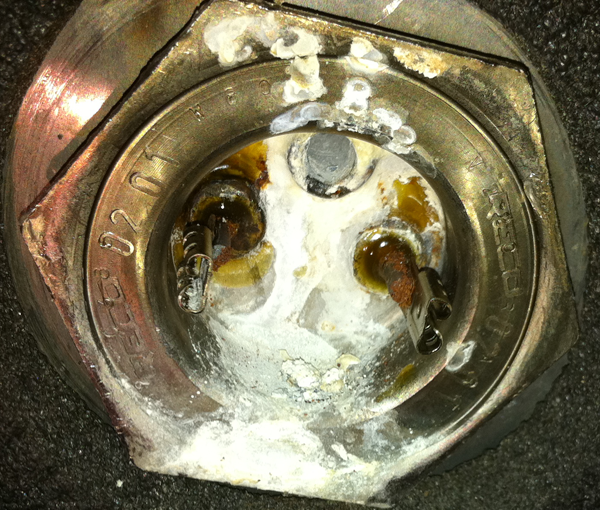

I've now got a picture of the base of the heating element, unfortunately some of the numbers are obscured:
It is made by Reco, so I contacted them with this picture.
I got a very unhelpful reply from Riccardo Oitana <commerciale@recogroup.it>: "The price for 1 pcs is 200,00 euro. Transport at your charge... If all condition are accepted from you, I can help you." This outrageous charge is clearly designed to get rid of me, how unprofessional.
So it looks like getting help from Reco may be a dead-end. Does anyone know what part this element is, or what make and size of cylinder was fitted to a Bavaria 47 in 2000?

« Reply #5 on: February 03 2013, 14:45 »
Update:
Got a replacement from Penquin Engineering
Element material: Incoloy
Length: approx. 30cm
Thread: 1¼" BSPP
Wattage: 800W
BBRINC08 INCOLOY ELEMENT 800W-220 VOLT ATI £29.17 + VAT
CASTATSN THERMOSTAT ALL CALORIFIERS ROUND + RESET £9.89 + VAT
UK delivery £4.15 + vat
