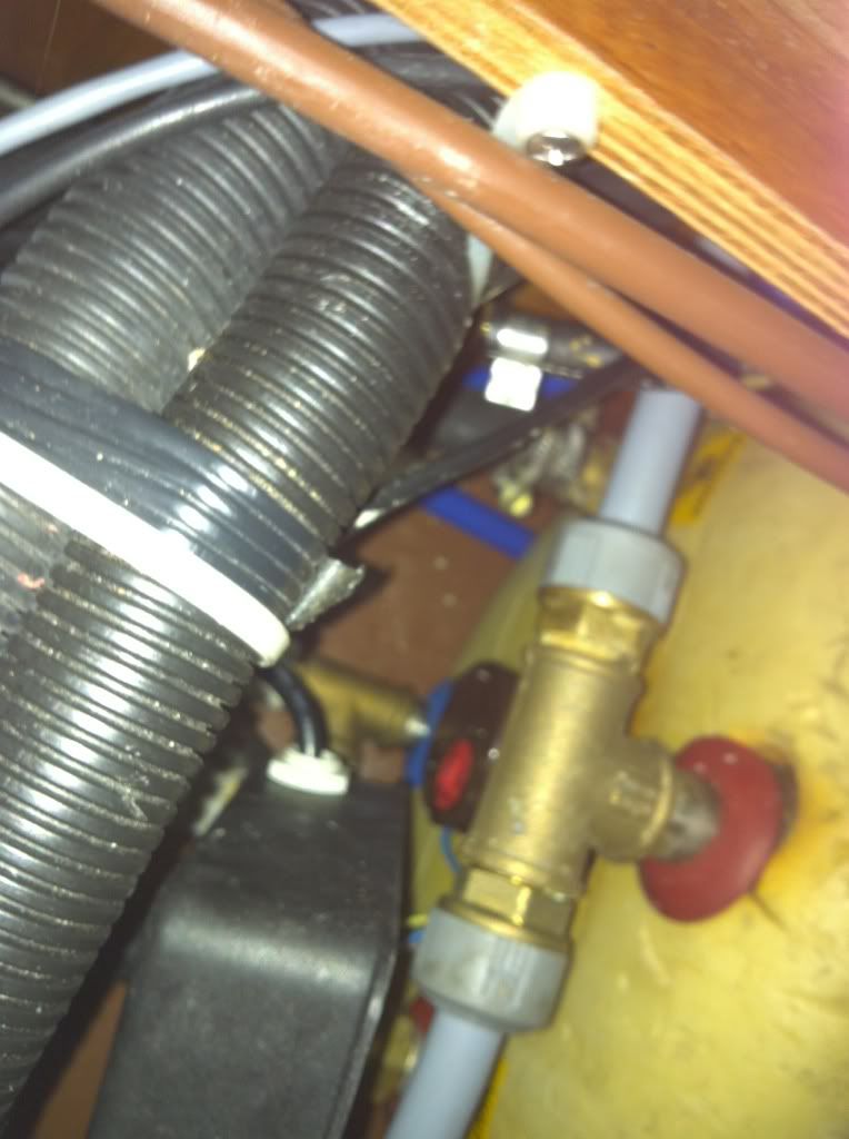

Right I had a look on my Bav30, and it was as expected coming from the calorifier. It was leaking around the Blue connector directly beneath the red connector shown in the picture. Not sure the best way of sealing it. I have tried waterproof sealent. I assume that should only be a temporary thing?
