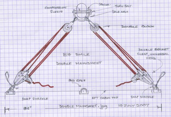

What the OP seems to mean is a coachroof double mainsheet, one on each side, instead of a traveller. This can achieve the same trim that a single mainsheet with a traveller can, but unlike a traveller you lose the trim, while a traveller retains the sail trim when moved on the track. Found a nice sketch of it here: http://www.pearsonariel.org/discussion/attachment.php?attachmentid=8705&d=1354456892

...Found a nice sketch of it here: http://www.pearsonariel.org/discussion/attachment.php?attachmentid=8705&d=1354456892 ...
excuse my ignorance but isn't the becket line going the wrong way round the block? I can't see how it works as shown.... (it's a nice drawing, though).
Re: german main sheet system.. possible to retrofit ? worth it?
« Reply #4 on: April 28 2016, 12:17 »
Sure is. Well spotted.
