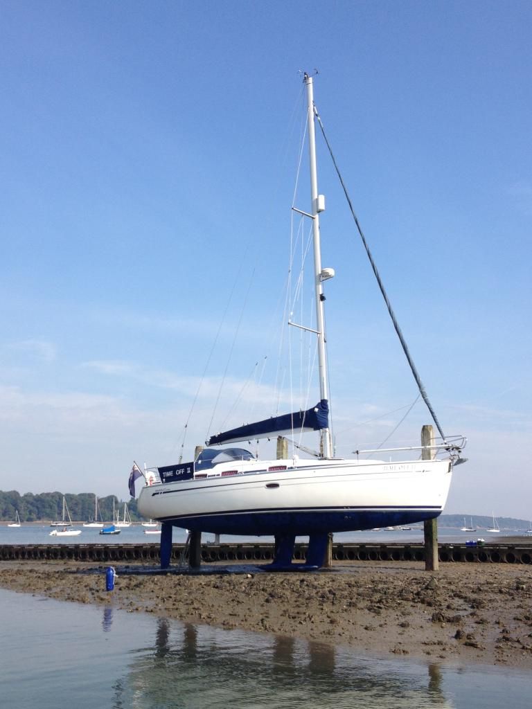

Hi
Yes you can dry out against the wall I have done this several times in my 36 but it is good to empty the water from the tank and get your fuel low as the centre of gravity is towards the engine so don't all stand and look over he stern :o Try to keep the boat off the wall till you touch the bottom then you can lean it against the wall so plenty of fenders and good ropes.

« Reply #4 on: January 18 2016, 16:55 »
Mick - what's the line from your port midships? Is that to hold off until she touches?

« Reply #6 on: January 18 2016, 19:34 »
Hi Mark,
Yes that is what the line was for just to hold off. The jetty is in a fast flowing river that was pushing the boat hard on to it, so we kept tension on till she touched then let her fall slowly on the jetty, after that it just sat there.  :tbu
