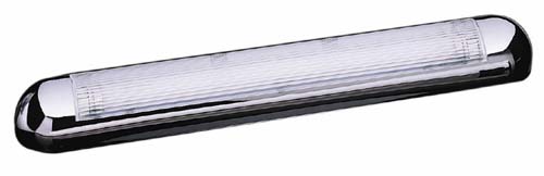

This is what the Rensch/Resolux 505 fittings look like:
