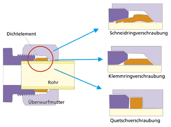

I took out the tank pipes, which interestingly where both the same length (to the bottom of the tank). I expected the return one to end at the top, but it doesn't really matter much. The old cutting ring (different from compression rings, also known as olives, see this illustration) fittings had bitten deeply into the pipe and needed to be sliced open lengthwise with a Dremel cutting disc and then split to be removed. I then sawed off the ridged end where the cutting ring had bit into the pipe, losing me only 2mm length on each pipe. If there is enough length to spare, just sawing it off after the cutting ring is a quicker way to get rid of it all. Then applied the compression ring (olive) fittings and put the pipes back into the tank.
