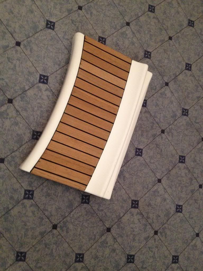

Teak wonder is brilliant stuff.
Unfortunately I don't have a "before" picture, but as you can imagine it had been exposed to the elements for a few years, after the cleaner, brightener & sealant you end up with this:

Can you indicate how long it stays more or less like this? What is you sailing location?
So you need 3 treatments, cleaner brightener and sealant. All from Teak Wonder?
Ger
Re: Teak wonder
« Reply #9 on: May 13 2014, 08:27 »
Yes, you need to use all 3 treatments.
It stays like that for about a year, and then each subsequent year you just clean it and then put another coat of sealer on.
