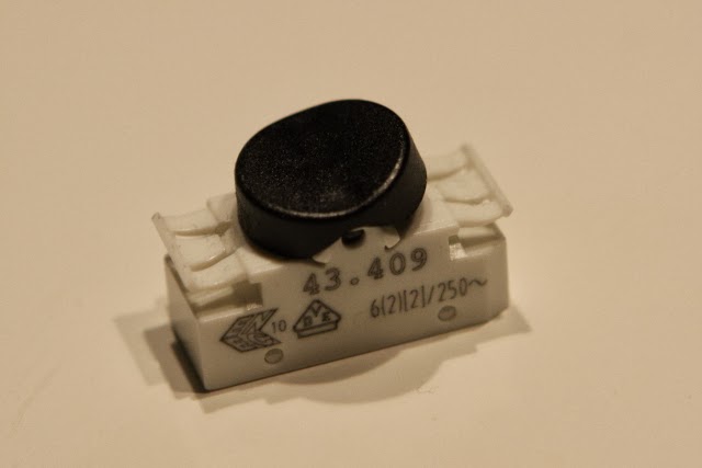

You mean this
The friend of mine told me that developer is from Germany. I'll try to get more info.
