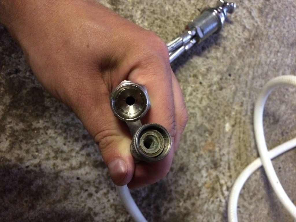

Following the discussion on this earlier thread: http://www.bavariayacht.info/forum/index.php/topic,1243.msg6880.html#msg6880, I would just like to share this with you. Despite the successful effort to clear the header tank problems, the toilet was becoming difficult to flush. I have a second pump on board (due to previous bad experience 'on voyage') and fitted this just in case that was where the issue lay. Nope, same clearance problem. I then removed all fittings up to the header tank from the pump and had a look at the 38mm 'up' pipe which fills the header tank [now is a good time to view the attached photo]. I have now replaced the pipe and all is well. Have you checked yours lately?  :sick
By the way, the photo is of the top of the pipe - i.e. the pipe was calcified the whole way up!

Thanks Stuart, we too use vinegar and several other products for the same purpose as you do. What is seen in the picture is a 10-year, 19,000 mile, accumulation and, whilst the 'visible' parts of the system are kept clear it would seem the 'hidden' elements are not  :-\
