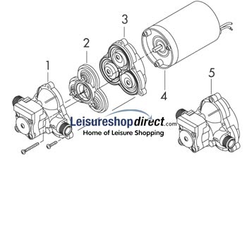

The Shurflo/Aqua King/Flojet pumps have a non-return valve that holds the pressure when the pump is idle. This may have a miniscule leak (often caused by debris) where some water flows back through the pump, thus slowly losing pressure back into the tank. Unlike a leaky hose, this isn't noticeable because there's no puddles. The aforementioned pumps are easy to disassemble and clean, so may be worth checking.
The valve is just a membrane, the center one labeled 2 here: http://www.leisureshopdirect.com/product_images/shurflo_lge.jpg

On our B36 the pump is under the rear bunk and if it goes off in the night it can startle the sleeping occupants! We had a similar thing, there was no external leak so the pump was turned off when not in use. Eventually the pump gave up and we refurbished it. No more leaks, so I am pretty certain that it was an internal leak causing the occasional bust of life. We still switch it off at night as the occasional late night teeth cleaner/face washer/hand washer uses the tap in the heads.
