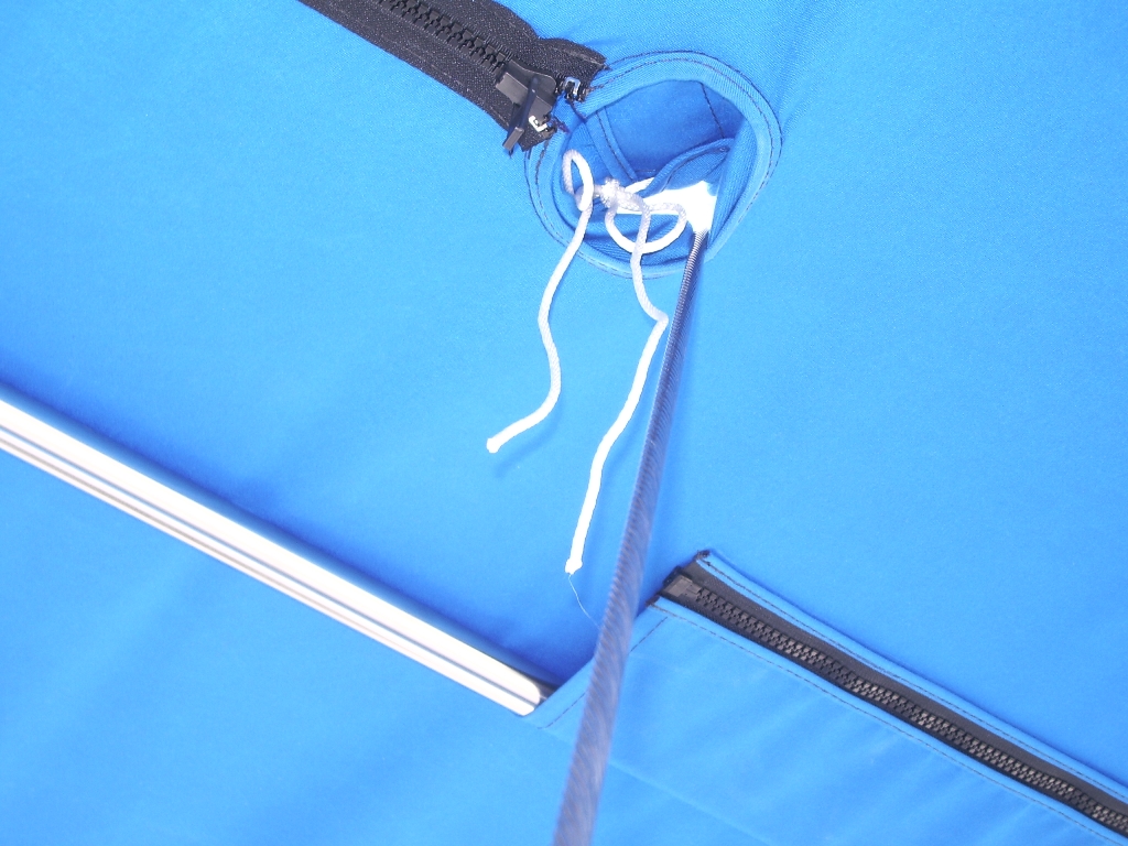

Don't have your exact set-up but do have my split backstay going through my bimini. The holes, about 3-4 inches in diameter are reinforced and there is a zipper going from the holes to the edge of the bimini with a velcroed flap on the outside to protect it. This way, it can be taken off and put on without removing the backstays. Hope this helps.

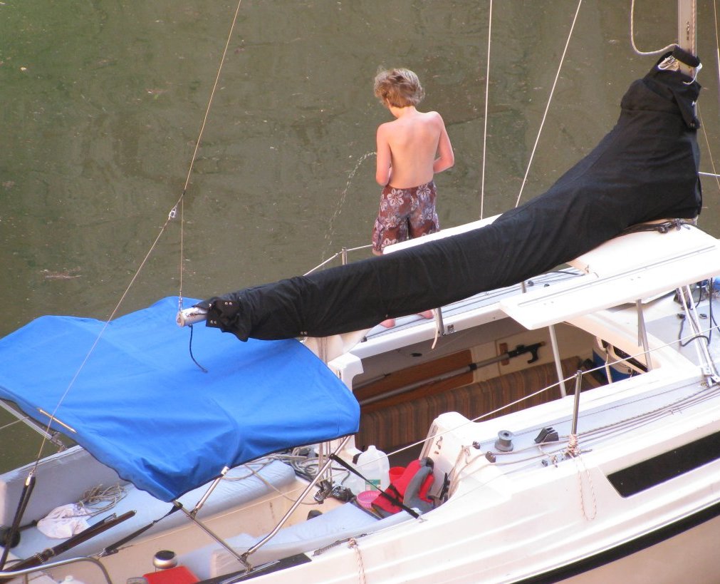

This is the best picture I could find showing my bimini.. LOL. . SORRY!!! That was taken a bunch of years ago back in some cove off the Escalante river on Lake Powell..

Walt, I don't see a problem. My bimini looks exactly like yours. Where the bimini attaches to the frame there is a flap and zipper. Unzip and the bimini falls off the frame. From the hole that the backstay goes through there is also, like I said before, a flap and zipper to the the edge of the bimini. While you have the bimini off while these mods are being done, remove the backstay and reroute it between the two aft bimini supports. This will bring your bimini aft a bit. You may need to re-anchor the frame to the cowling but, it looks like it's on a track so relocating should be easy. Unless this is a DIY project, consulting a canvas man might be best. I'll try to find a picture of mine and post.

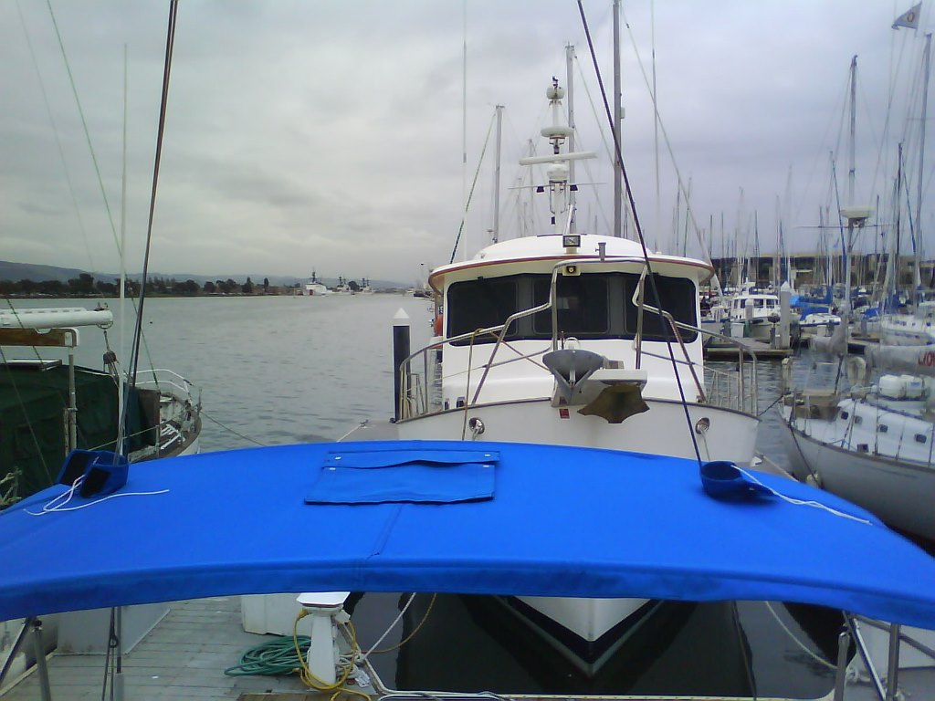

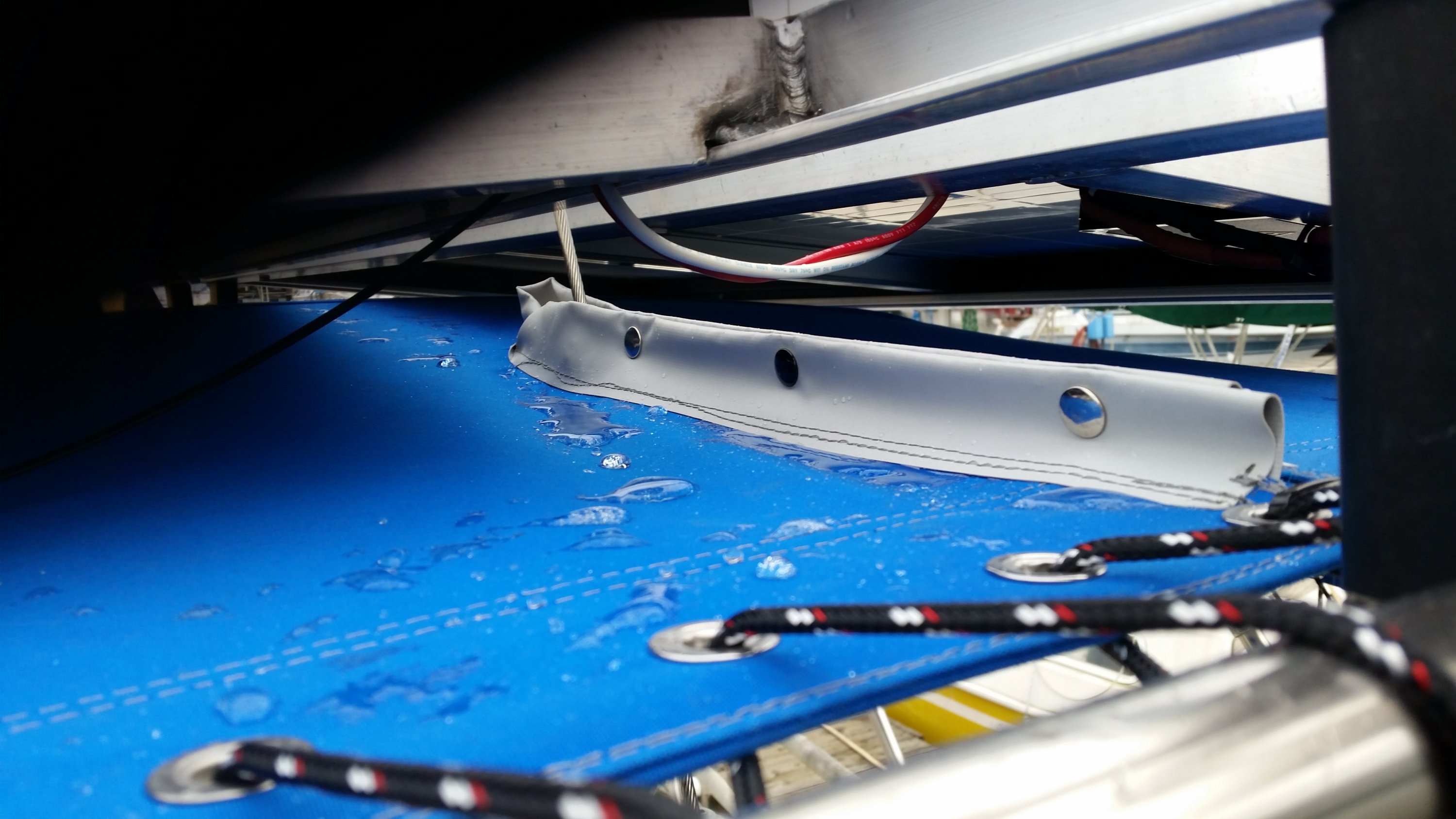

My bimini (bought right here at the SBO store) has little boots sewn into the holes. Works good to keep the rain from cascading down a hole onto our heads. Pretty clever design. If yours is far enough back it might not be an issue, but can't hurt. The cord allows the opening to be cinched down tight to the backstays.

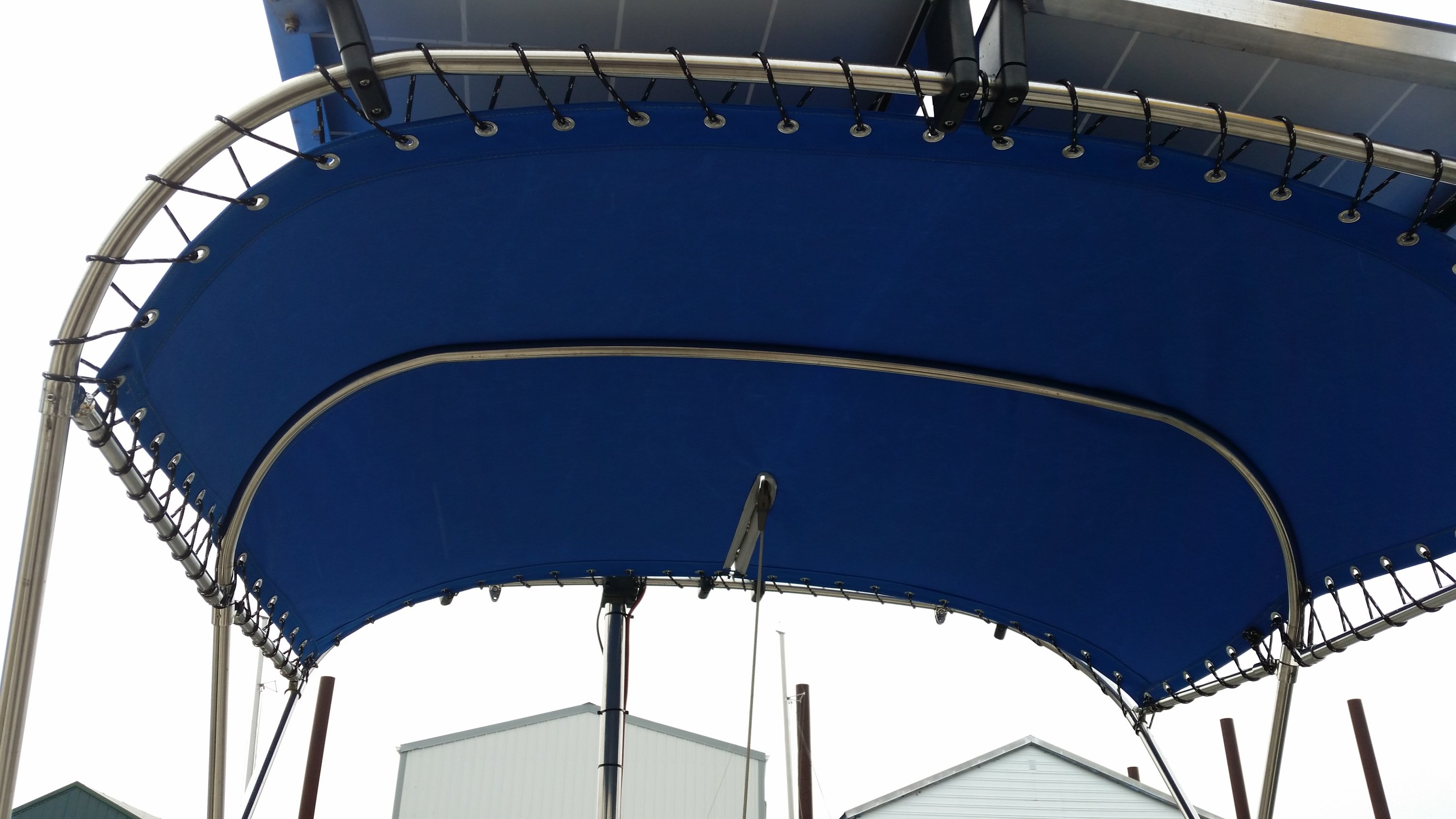

Can you just move the bimini forward a couple inches to avoid the contact. I no longer use a bimini because I have solar panels there now that serve the same purpose, but when I did, I had it mounted like above. Still had shade and no problem with the backstay hitting the bimini. I put the tracks on, but didn't really need to have them, as I always kept the bimini in the same spot.
I did like the quick adjust support bar as I could keep the bimini forward if I wanted so I could pretty much walk past it and ...
... could also let it back if that was better. Bimini install starts here...

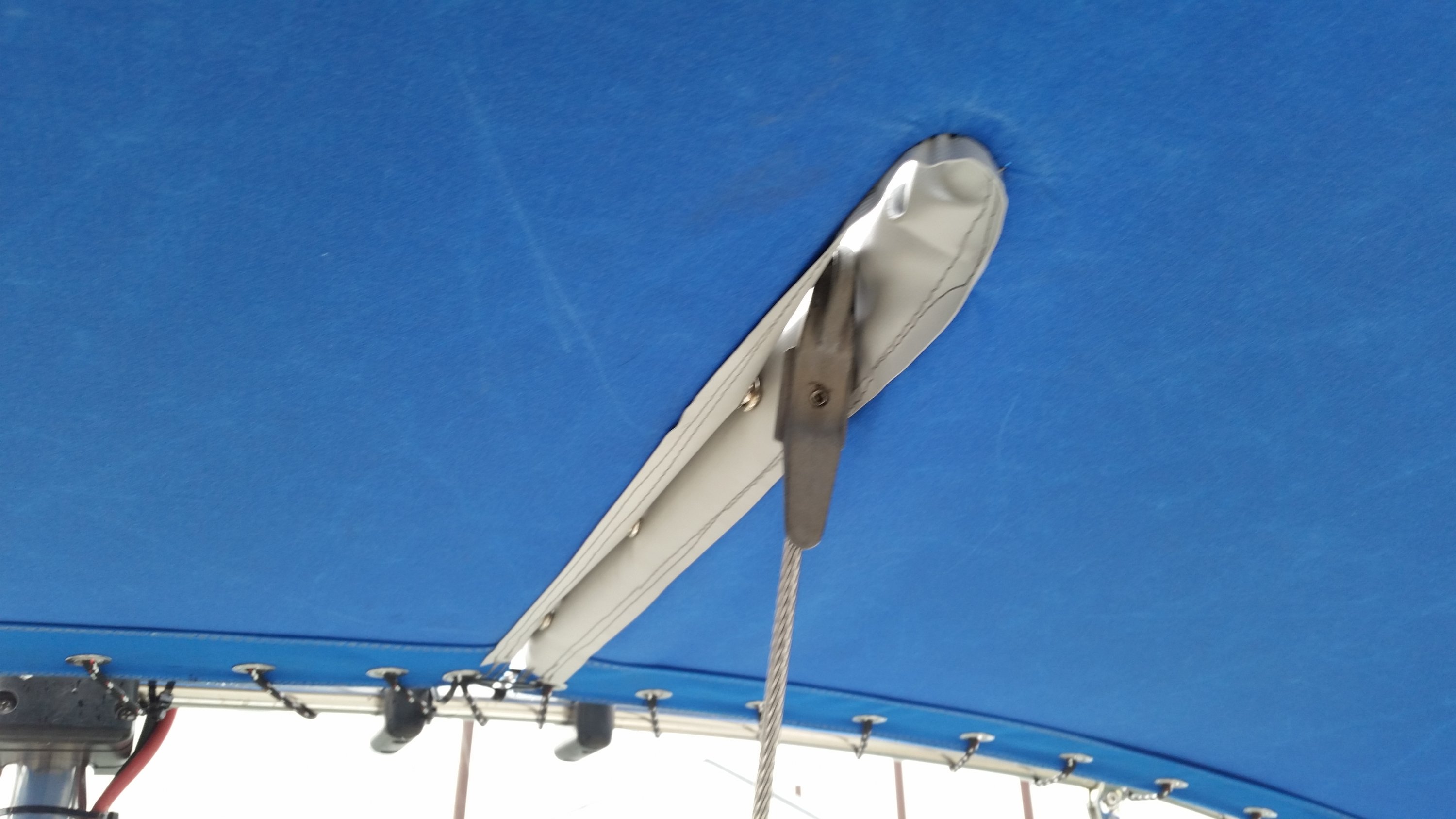

EDIT.... after looking at the photos of Sumners reply, my solution really doesnt solve your problem UNLESS you take the backstay loose and take it inside the rear bar of the support frame.
it probably doesnt matter if you use the bimini full time or part time, but what I did to solve the backstay issue was to locate where the backstay was in relation to where the bimini would be, and then cut a slit from that point in the bimini to the edge.... then I sewed a piece of truck tarp material to the raw edge to make flaps that I could attach snaps to.... this way it sheds most of the water off the back/sides, rather than running thru on top of me....
I thought about using sunbrella to make the flaps out of, but there is movement in the bimini vs the backstay, and the truck tarp material has much better wear/chafe resistance, so it should hold up much better over time.
I am going to take a look at moving the bimini forward a little bit. Looking at my picture I posted earlier, I likely would not need to move the bimini much, maybe just several inches. That picture has the boom held up by a pig tail off the backstay and I could tolerate the backstay hitting the bimini in that case. Its just while sailing and where it may see a fair amount of tension that I dont want any interference from the bimini. Just have to get to the boat to see.

Walt, taking the backstay and gear off makes sense in your case with the gear you are using vs. the absence of gear that I'm not using :).
On the Endeavour the backstay goes through the bimini and you are not going to unfasten it to put through the bimini. We used Top Gun ...
http://www.sailrite.com/Top-Gun-Navy-Blue-62-Fabric
... from Sailrite for the slot area.
They claim ... "Highly Abrasion Resistant: 1,000,000 double rubs" ... for it.
http://purplesagetradingpost.com/sumner/endeavour-main/canvas-3.html
You can't really see it in the picture but behind the slot, that has the Top Gun surrounding it, is a flap that is secured with 'common sense fasteners' . I cut the back horizontal frame member on the bimini frame and have a tube that spans the cut on the inside. When we get to the boat we put the bimini up, open the flap and split the frame and move all of that behind the backstay. Then slide the frame back together and close the rear flap behind the slit.
Ahead of the slit is a window....
... so that one can see the windex on the mast while sailing (if we ever get to sailing :(). The window has a flap also that covers it when you don't need to see through it, so as to protect it from the sun.
