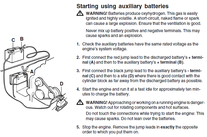

This sounds like a good idea, but is there any problem with just having a good set of jump leads on board? Would the common negative (if present, as on Figaro) cause any trouble?
Re: Engine won't start
« Reply #10 on: April 13 2015, 12:19 »
I'm with Mark on this. Just keep some jump leads on board.
Marchi
  • Posts: 27
« Reply #11 on: April 13 2015, 12:54 »
For avoiding dead batteries instalation of 10-50W solar cell with regulator is recomended. Cost, 30-100?.
And yes, jump leads on board is good idea! See Volvo manuals for wiring if necessary. It "saved my life" once.

I am not an electrician (being a mechanical engineer) but can I ask if it wise to connect the full domestic batteries into circuit with the dead engine battery? Would it not be better to use a double pole switch which would break the engine battery circuit and connect the doms battery set to the engine controls?
« Reply #17 on: April 17 2015, 08:05 »
Hi BillGiles,
You have a point that I've often thought about and cannot answer except to point you in the direction of a similar situation when your car won't start. At that point along comes Mr Helpful Citizen in his car with a set of jumper leads which he connects between the battery on his car and the battery on yours, and your engine gets started. Essentially it's no different from the set up on my boat. If you call a garage, or your breakdown service, they will do the same thing. The important thing to remember is to break that temporary starting connection as soon as the engine has started, thereby allowing your alternator to recharge your engine start battery.
« Reply #18 on: April 17 2015, 08:58 »
It would, and it's easily achieved by taking the feed from the new emergency switch to the engine side of the engine battery isolator.  Then, by switching the engine battery isolator off before activating the emergency switch, the domestic batteries are not connected to the dead starter battery.  If the engine battery isolator has a removable red handle, get an identical switch for the emergency use and only use one handle for both switches - then the battery switch has to be turned off before the handle can be removed and used on the emergency switch.
