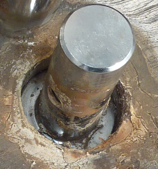

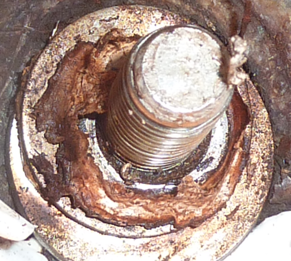

I've had a leak from one of my stanchions for some time, so I started to investigate today. The underside has an M12 stud with pair of nuts, but I can only get one off as I need a deep 19mm socket. [Note to self: horizontal screw is M6]
I'm not sure how this fits together, what will I see when I manage to get it apart?

The top [non threaded part] has a collar which sits onto the deck/hull joint, the nuts tighten onto a large washer. Plenty of goo seems to work.Geoff

I had to  reseal several this November  as they were leaking. Between the main flat washer and the nut is a sping  washer.
What I found was: there was no  sealant under the base except for the edges of the drilled through hull hole. Also this hole is close to  the hull side making the flat washer lie at an angle - bending when the nut is tightened.
What I did was - clear out old sealant in drilled hole and thread of base, apply much  sikaflex down the drill hole and into socket ın the toe rail (Temporarily plugged underneath) before inserting the s base I placed 2 O rings into  the mastic (one the size of the thread the other almost the size of the base diameter so  that there was a layer mastic retained between the base and the fiberglass.  When you insert th s base into the socket - not much thread will extend into  the hull - you have to  pull it down as its tightened. Also you may need to  change the flat washer for a smaller one or cut one side so  that it sits flat. Finally before fully tightening make sure the holes in the base align with the stanchion.Think about guardrail wires. Its a messy job easier with 2 people.
