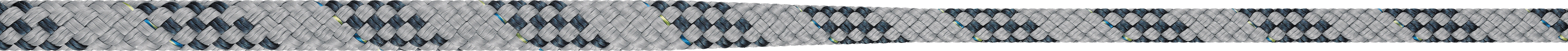

I have a Bavaria 44 / 2003 and had the same trouble, too much rope on the furler. I am using now this:
https://www.liros.com/catalog/en/taper-pro-9mm-20m-auf-6-mm-10m-30m-p3540/
from here:
https://www.fockschot-shop.de/de/fallen-schoten/liros-reffleinen-spezialausfuehrung-02010/liros-taper-pro-silber-stahlblau-9-6-mm-30-mtr
My furler line is 30m long 15m 9mm and 15m 6mm. The 6mm part goes to the furler first (not filling it up) and the 9mm part is where you can grab the line and it won't cut your fingers. It is a bit expensive but I am very happy with it.
I see they have changed the proportion to 10m of 6mm and 20m of 9mm but the effect is the same.
Maybe for an Ocean 47 you should take the 11mm/8mm version.

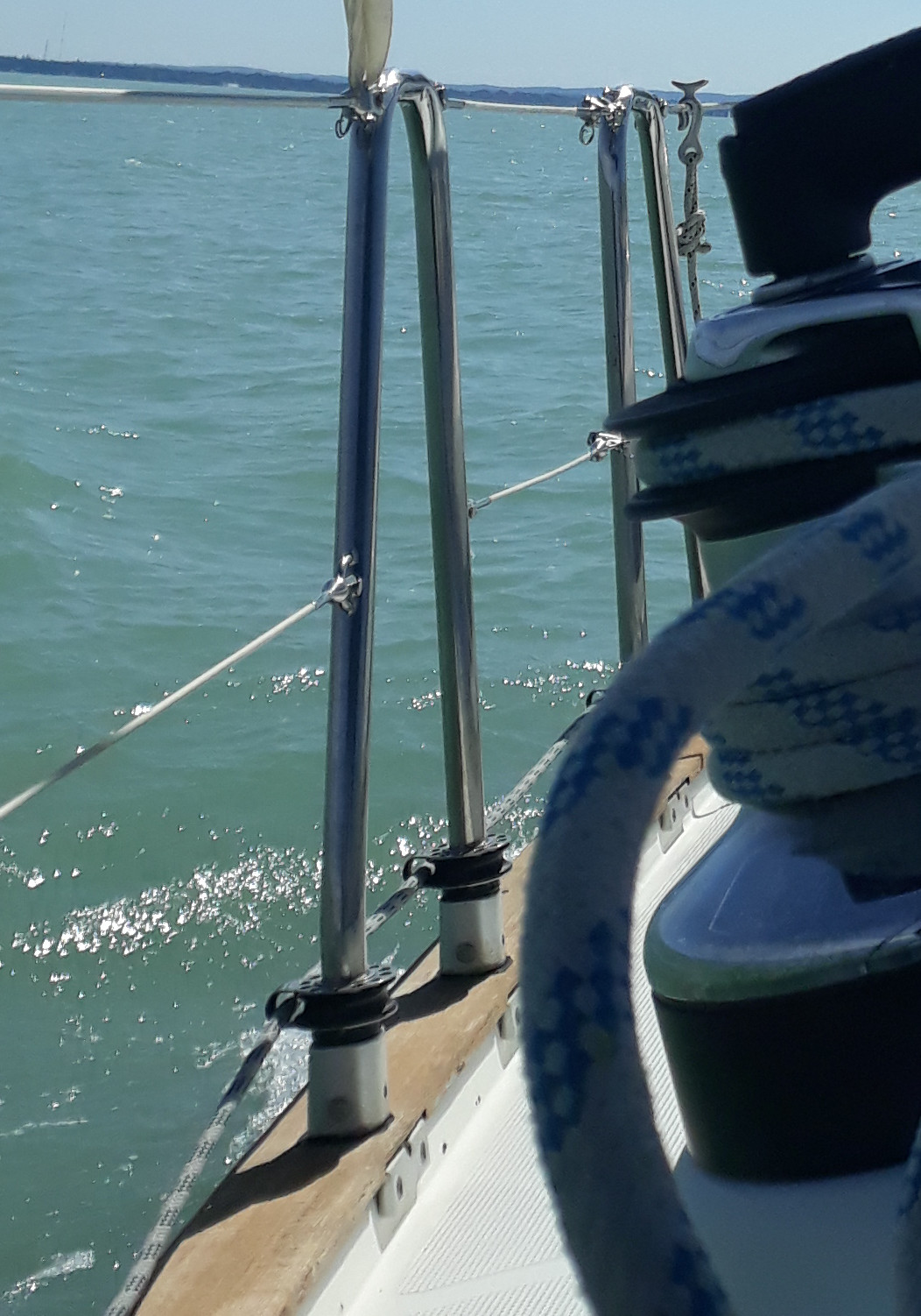

 I also installed furling blocks on the railing, it makes furling much easier.

A normal 40-sized ST winch can usually handle ropes from 8 to 14mm. But since I changed the furler line to this and installed the furling blocks with ball bearing I can simply roll the genoa in by hand. (With the original Bavaria blocks attached to the railings bases it was a much harder job.) If there is too much wind you still can go downwind and hide the genoa behind the main - it makes furling easier. I even bought an electric winch two year ago to be used as a genoa furler winch but at the and I did not install it. I always can roll it in by hand.

The furling blocks look neat - can I have a reference. I assume to fit its necessary to take the stanchion out and slide the block on ?  I think to go with standard 10mm polyester braid which should be strong enough and see if that stops the jamming.

They clamp around the stanchion. No need to dismantle. This is a kit with all the bits

I used these:
https://www.segelwelt.at/shop-de/2302/77/bootstechnik-bootszubeh%C3%B6r/bl%C3%B6cke/umlenkrolle-f%C3%BCr-rollfock-detail.html
and yes, you have to take out the stanchions one by one - this it is not a big deal.
I found these better because they have ball bearing and run smoother.
