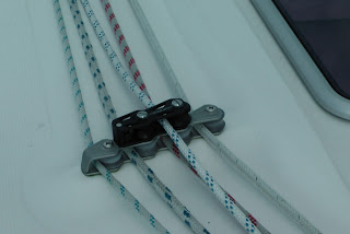

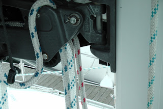

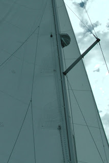

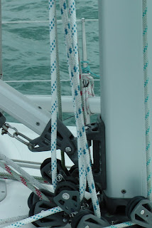

1. Shows block on main sail
2. Double turning block at foot of mast
3. Piggy-back deck tidy
4. exit point at goose neck (middle of the three lines going down to turning block
