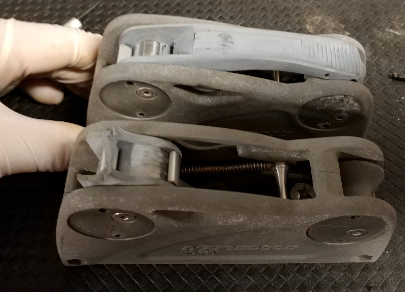

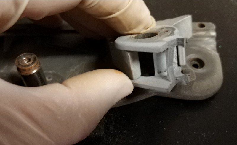

The other day I was trying to close the starboard clutch lever on my Bav31. It snapped right in my hand, leaving no way to open or close it without using tools.
It is equipped with Rudgerson clutches that have probably been directly under the greek sun for almost 19years now. Without second thought I removed both starboard clutches for further inspection. And then the port ones too.
The plastic levers developed tiny little cracks at the top, that were more visible under lablight. More like the material itself started to lose its integrity and became more brittle, so when I insisted it broke clean.

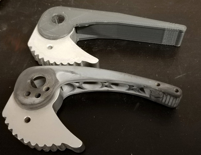

Being a know-it-all guy, I thought I should redesign the part to have more material inside. I feel safer knowing there is a stronger mechanical bridge between the cam and the lever. The original lever has some hollow parts underneath it. Perhaps to save material. Perhaps because under normal circumstances it would have been replaced already and not stayed there for so many years.

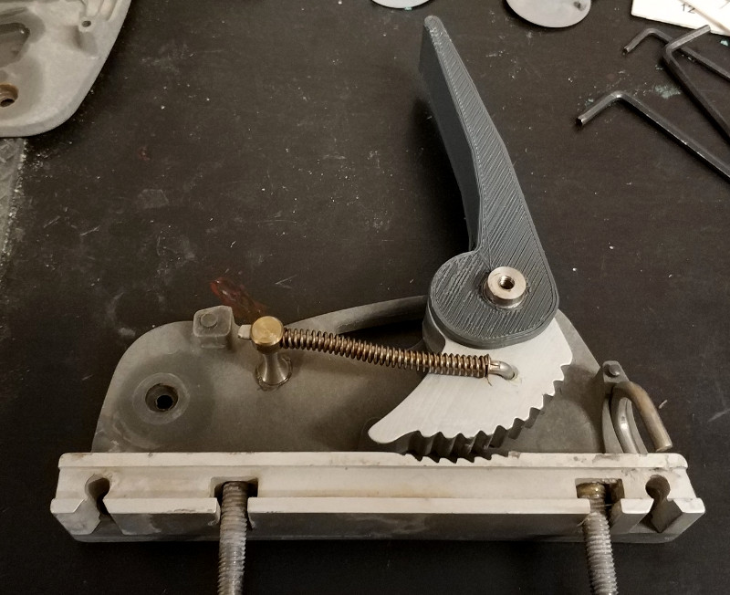

3D printing is our friend. I was lucky to have had grey material to match the colour of the clutch assembly. In terms of material strength, on paper, it looks like it could work.
You can see the new part in place, next to the old one. Good thing is it fits and is as well behaved as the original one.

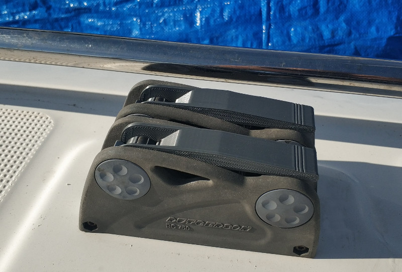

This is what it looks like onboard, with the new parts installed.

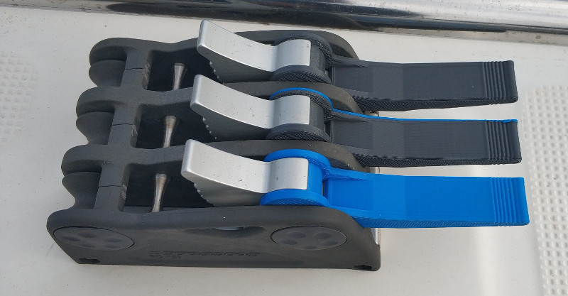

I did get a bit carried away and started experimenting with other colours. The original levers were going to give up very soon, which I found out after I had removed them.
Hopefully there will be time to test the new parts in club races this season and be back with more information on this mod.

Printing in different colours would probably be overkill for any reasonably priced 3dprinter,as it requires a separate head with a different filament. But it is definitely possible to emded letters or names in the design, of the same colour.
By all means, this is work in progress. I am more concerned about testing. How well they can last in real conditions, before anybody else tries to use them and finds himself with a boom falling on his head or losing tension on a halyard while underway.

What did you print them in, ABS? I'm not sure, but I think the original ones might be glass reinforced Nylon and thus (originally) stronger than ABS.
Printed in PLA. My ABS and PETG test samples were not as strong, whether you believe it or not. ABS was brittle, not nice to print or test, so that option went out the window. PETG seemed brittle too, with much poorer layer adhesion, but my spare set is PETG in case I end up with planB.
The million dollar question is whether under the summer sun all will melt away. I will run some in-car testing to make sure.
So far, temperatures have gone up to 26C with full sunshine where the boat is and no deformations noted whatsoever.

40C, full sunshine during the weekend. First heat wave of the summer and all held well. No deformations, clutches hold.

Unfortunately it was the heat that eventually deformed the handles following consecutive exposure to heat and sun over 30C.
I made new ones from PETG, they held properly throughout the summer and the -smallish- club race season.

This is what the white PETG handles look like. From the few club races that were done this year in between lockdowns and covid mayhem.
I would very much like for more testing to be done on them, as I have only had them on for about 6 months now. Done 4 races and a few weekend island hops.
