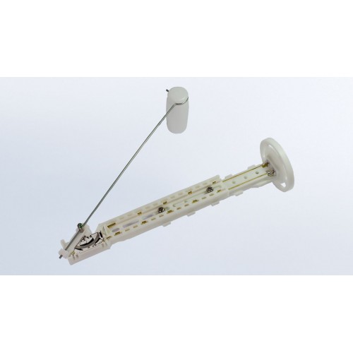

1. Do you or others happen to know the make of the sensor? I have this model on my 2005 36. I would like to obtain instructions to adjust the sensor so it is actually working more accurately.
2. Also do you have to disassemble the sensor to remove? I haven't found the magic angle to remove.
3. Stumped after lifting the sensor out slightly, to find the 150 litre tank with the diesel level very close to the top even though I put 33 hours of motoring since last fill. At 1.8 - 2.0 litres / hour  I should be down 60 to 66 litres!!!
It's a VDO sensor. Instructions here: https://etbinstruments.com/image/data/floatarmvdo.pdf
I didn't have to disassemble mine, but it was quite tricky. Perhaps it's easier if you do.
No idea why your engine uses no fuel, perhaps the diesel fairy came and filled your tank or it rained into it ;-)
