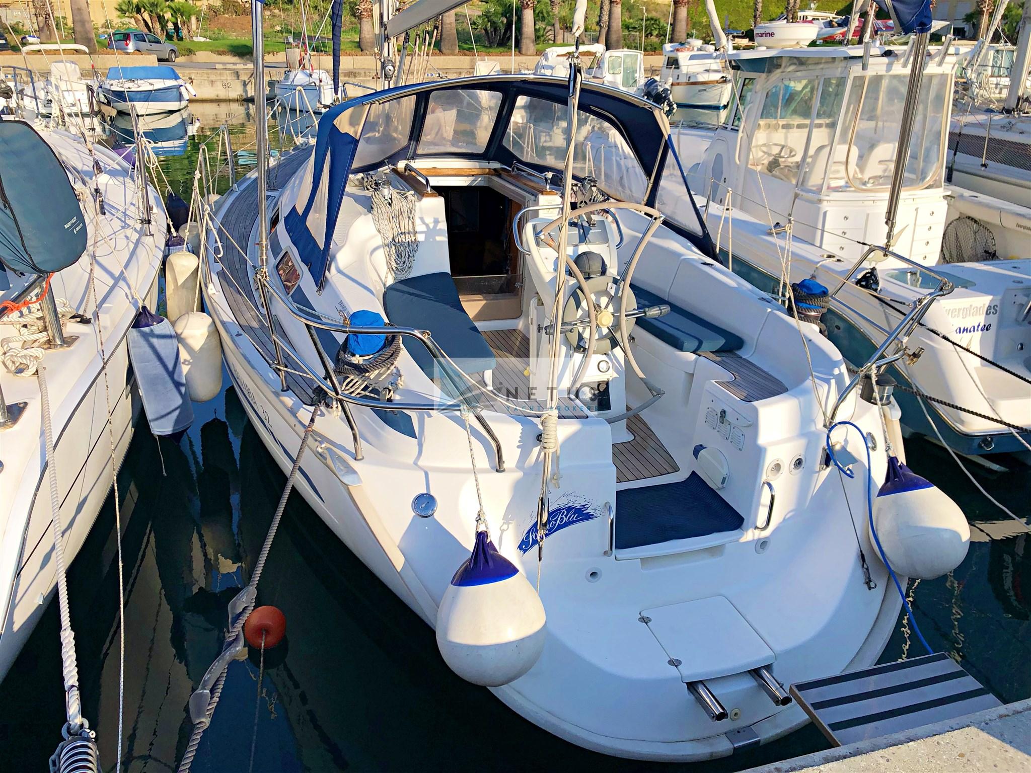

The furling line is normally routed along the bottom of the stanchions on one side all the way aft to the cockpit and to a jammer there (rope clutch on bigger boats).
You can look up your boat model on Yachtworld and find pictures of the setup, like this one:
