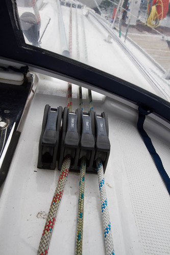

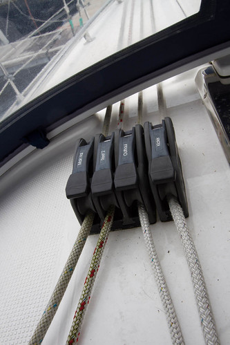

Hi
These pics may help. The starboard set now have another single clutch since the pics were taken and that has the genoa halyard. The main halyard is at the mast.
Al

Please if possible to have some pictures around the mast to see how the brake blocks is attached so I can see what is in each of them. I all reedy have you photos from the rope clutches so I have the color coding for the lines.

« Reply #11 on: June 29 2013, 19:23 »
Hi KMS
Photos as promised.
Al

Helpful pictures, Algey: may well help us sort out our rats' nests when we're next on board!
