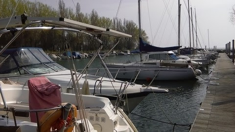

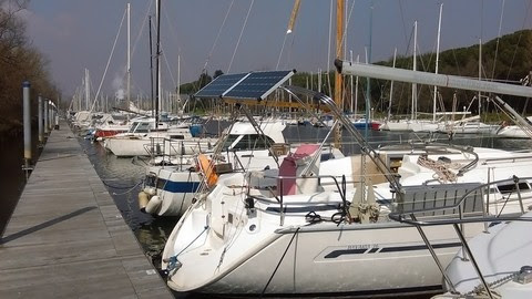

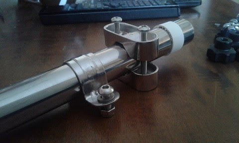

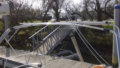

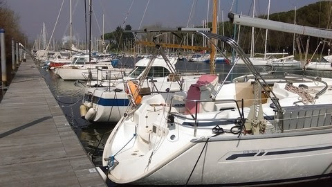

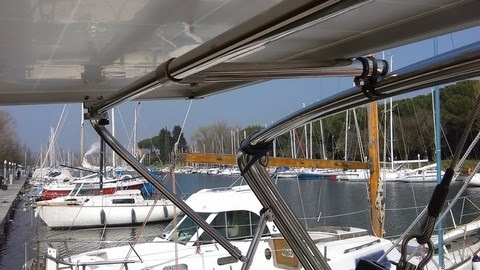

I done this last spring on BAV 36, just adding one more element to bimini and for stability use the frame of solar pannel it self.
2x100W, 2x5,6kg,
horizontal rotation
Cabel to regulator 4mm2
Y conector  ++ / --
Regulator Tracer Mppt 20A
Like this
or like this
nonvisible
Conector Y
Just added one more element to bimini construction
Rotation variants. The small one on the left just work great.
