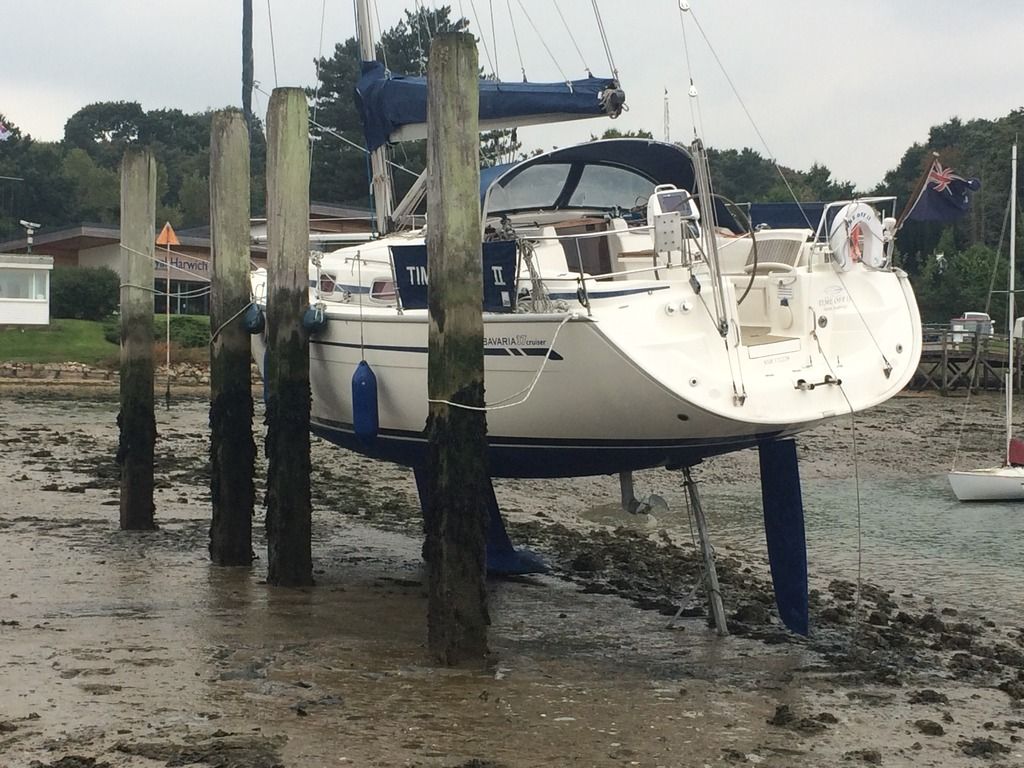

The default shallow draft keel (cast iron) is a bulb shape (data sheet with sketch), while the upgraded deep draft (lead-antimony) is a dorsal fin type, as depicted here:
It may need support under the bow to keep it from pitching over forwards (at the very least trim weight aft), but can rest on the keel just fine.

I think I would risk drying out on that keel. For the first time I'd have a pole to support the bow.

On a slighty different note - I tend to find that my Bav 37 (shoal draft) tends to want to sit back on the rudder - hence I put the support in (well actually a friend in a wetsuit did!)
